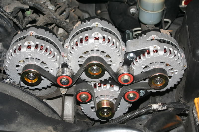

  14. Apr 14, 2020 at 7:59 PM
    pdaddy
    pdaddy WeLl-KnOwN mEmBeR
    Sep 10, 2019
    #304930
    2,641
    Preston
    Central AL
    ‘13 DCSB Converted Prerunner 4wd
    Holy sh** that may as well be a second engine! Who makes that???
  15. Apr 14, 2020 at 8:00 PM
    0xDEADBEEF
    Mar 2, 2019
    #285037
    19,656
    2000 reg cab 4x4 flatbed MT
    Look closely at the idler pulleys - thats a home job.
    Probably some car audio guy or one of those nutso radio yelling contest people. I pulled it off image search.
