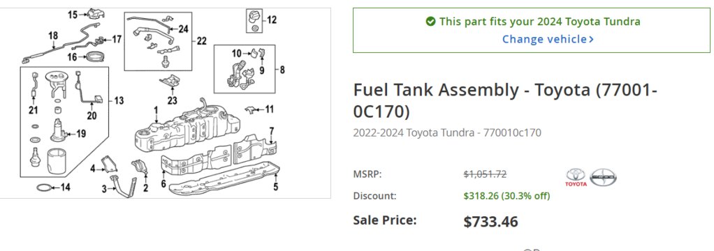

    That's the $2,500 tank ($2,445) that I mentioned. A new oem Tundra tank is considerably less and available in 22.5gal and 33gal sizes. Could probably pick up a used one for a couple hundred ... just not sure if it fits.

    I'm getting about 350 a tank, refilling within a few miles of when the light comes on. If I got a 33 gal tank, my range would be over 600 miles. I'd just be driving around with a lot of extra weight. On the highway, my other tank (my bladder) isn't going to last that long so I'd be pulling over long before that.
    I know, if you're towing or off-roading your mpg and range will be way less and 33gal may make sense. An extra 4+ gallons though, from a Tundra tank for $733 (if it fits), I'd probably do that.
