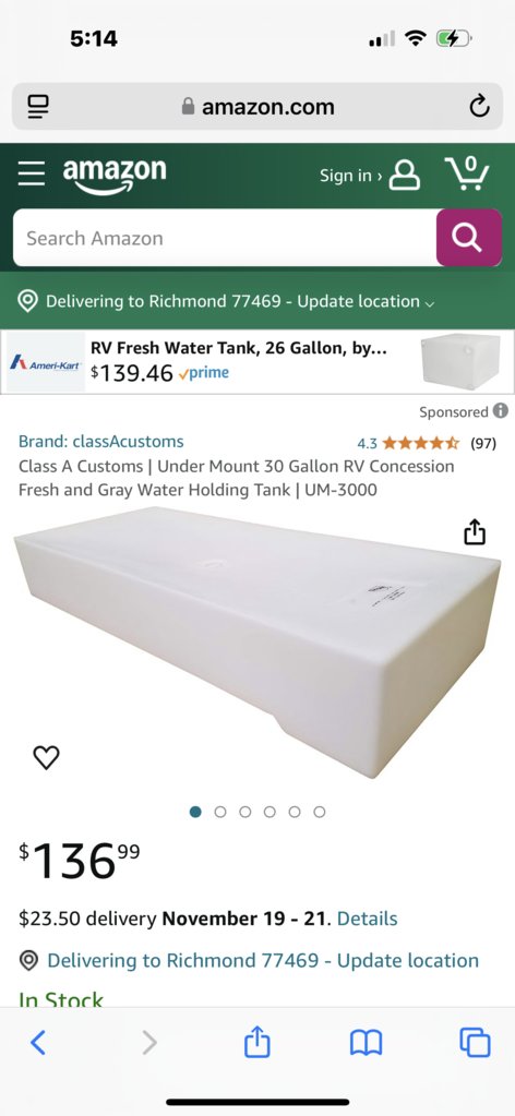

    IMG_4901.png Ok biggest
    Again, thinking out loud
    What about a RV black/gray/fresh water tank?…..under bed
    Would take modifying to fit and to adapt filler hole for FP
    But
    Huge range of “shallow” sizes
  18. Nov 14, 2024 at 5:06 PM

  19. Nov 14, 2024 at 5:10 PM
    #19
    OnHartung'sRoad
    OnHartung'sRoad -So glad I didn't take the other...
    Jul 24, 2017
    #224878
    9,477
    Somewhere in the Mojave Desert...
    2017 Tacoma OR 4x4 (formerly 2002 OR 4x4, 1995 4x4 4Runner, 1985 4x4 Toy PU) ... and RIP’s (rust in pieces) to a Bronco II 4x4 & S10 Blazer 4x4
    Don’t use water storage tanks for gasoline! They are not rated for fuel storage nor thick enough to survive accidents and can split open easily.
    Titan sidekick
    - it’s pricey but built to take hits. Works well in my DCSB OR, especially when we go remote camping or need the extra fuel for our RV trailer trips. I do truck and Sidekick fill up runs to a local gas station at a Rez and have discounted gas that way all the time.
