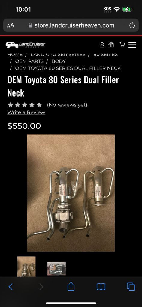

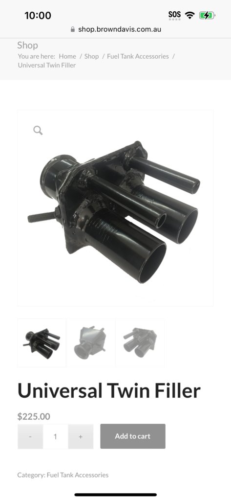

    Fox 2.5 DSC resi CO's w/ 700lb King Coils, Camburg uca's, T-100 rear leafs, 13WL Tundra brakes, 1" 4crawler body lift, 295/75/16 Hankook MT, Ruff Stuff u bolt flip, 10" Fox LSC resi shocks turned back on custom mounts, home built rear high clearance bumper with dual swing outs, Diode Dynamics SSC2 Pro rear floods, Skid Row front and transfer case skid, home built transmission skid, Mercerfab sliders, home built front bumper, Badlands Apex 12k winch with synth line, 4.56's, ARB rear locker, home built rack with CVT Mt. Shasta, eBay snorkel, Sierra LEDs 20" dual amber/white light bar, Diode Dynamics SS3 Max amber fogs, Mini D2S projector retrofit, Blue Sea ML-ACR, dual Odyssey PC1200's, 100 watt solar panel, 20 plate heat exchanger/home built shower kit
    I wouldn’t use anything other than an approved fuel tank, they’re baffled and vented to ensure they’re safe/function properly.
    With the research I’ve done, some people had issues filling tanks or getting them to transfer if they weren’t properly vented.
    I want to use the F-150 tank in the spare tire spot, biggest issue for me is the filler neck location. I don’t want one in the deck of the bed since it’s pretty much intended to be a clean space inside a camper, and clearance is tight in the bed sides to add a location behind the driver rear wheel well, and as much as it wouldn’t seem possible, I want it to look clean/factory.
    The dual tank 80 series had a double filler neck with a pull valve to switch tanks. It’d be cool to make this work but it’s as DRR mentioned, parts are very hard to find and/or expensive and often have to be sourced outside the US.
    The other option, and hopefully the one that would work is a directional double fill neck that’s basically a Y, parts seem easier to source and it’d be much simplified.

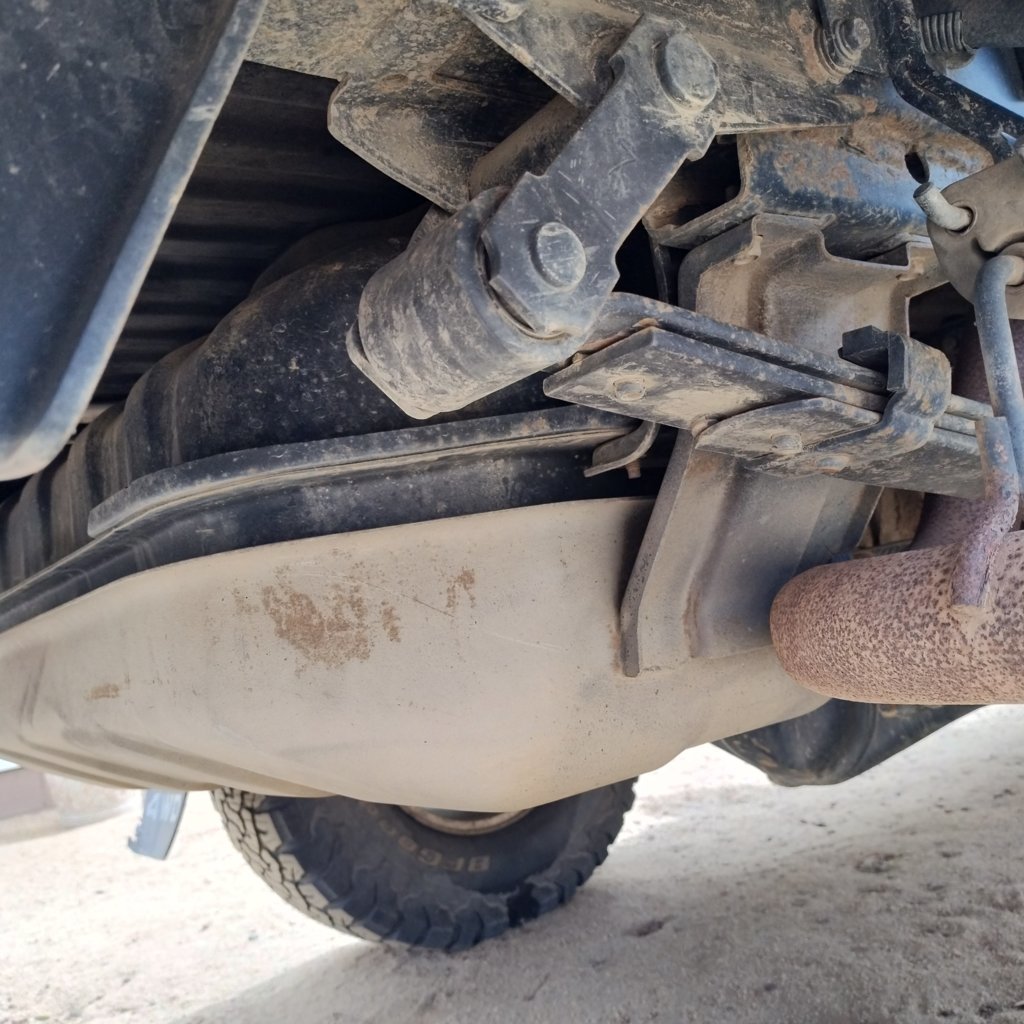

  9. Nov 15, 2024 at 2:48 PM

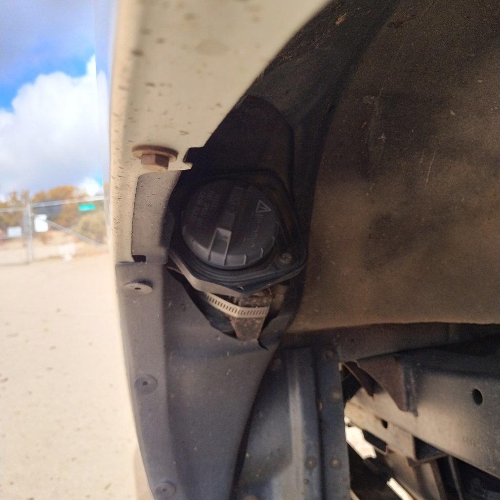

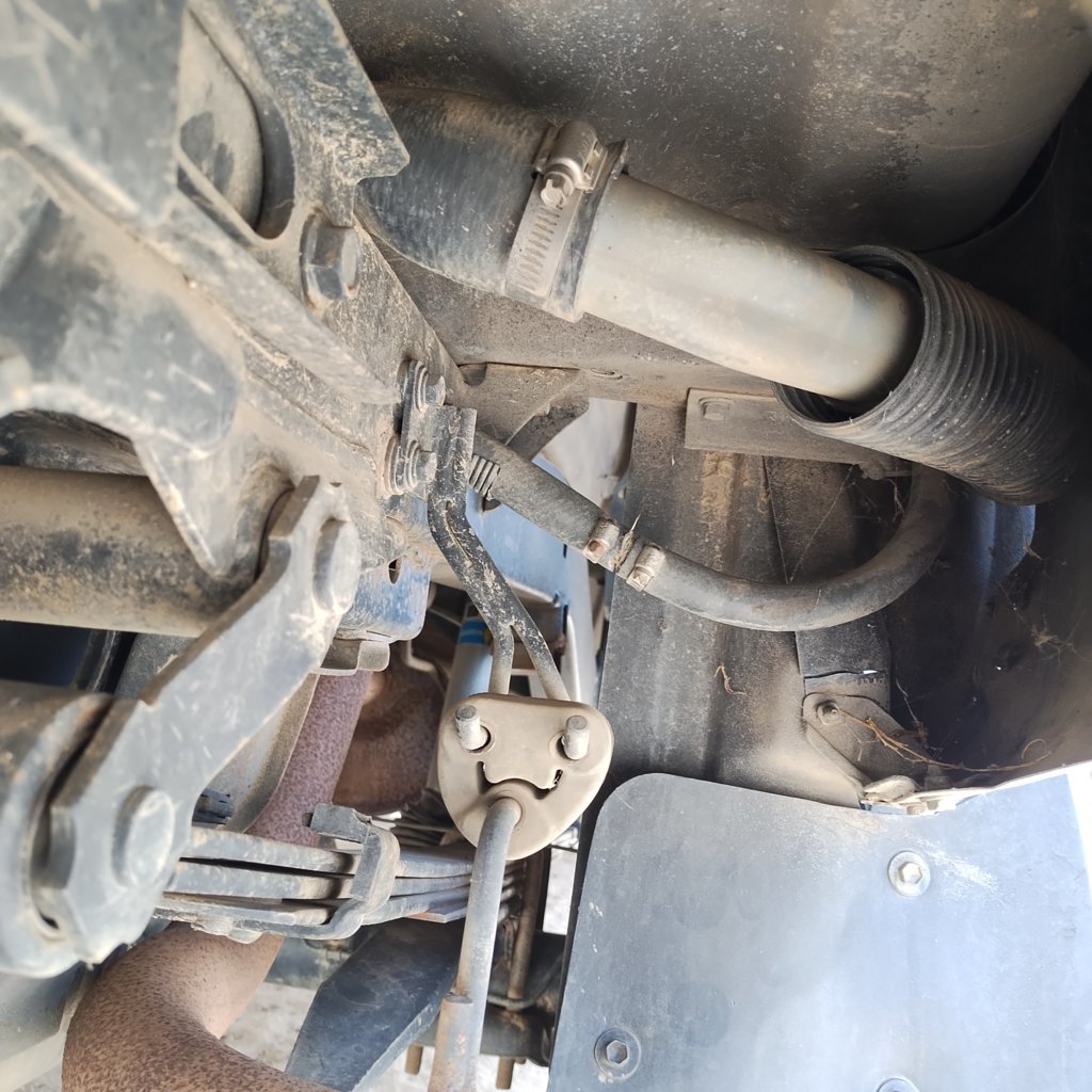

  13. Nov 15, 2024 at 4:19 PM
    #33
    mechmn1
    mechmn1 Member
    Aug 20, 2024
    #455554
    23
    Anza, CA
    2000 tacoma 4x4
    factory rear locker, front limited slip, 21 gallon fuel tank in spare tire location, winch bumper with factory bumper cover, rear add a leaf, front Fabtech adjustable suspension, Tundra front brake upgrade, 16x7 2001 4runner wheels
    I use the stock fuel pump that was in the donor tank to pump fuel to the stock OEM tank. I connected the 5/8 vent hoses from both tanks together so no venting problems while transfering fuel. It has a gauge sender but I have no fuel gauge for rear tank. The filler neck and the skid plate are all from the same donor vehicle.
