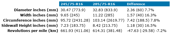

    this chart is for dummies like me, thank you guys for your help. its perfect:cheers:

    that seems to be the ticket. same width and a little height on that chart. that charts awesome , you put stock tire right next to new to compare difference .cool.... thanks again:D
