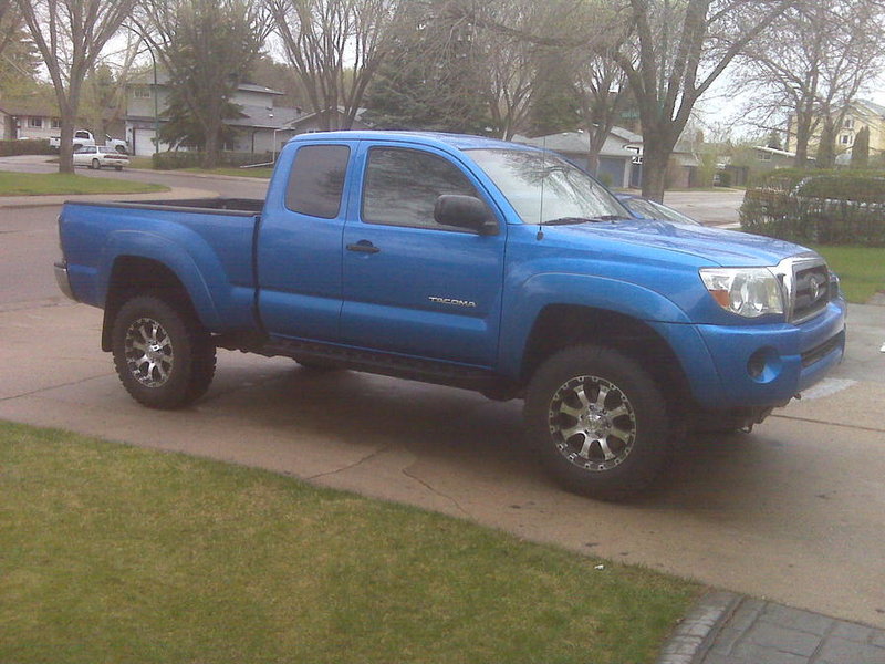

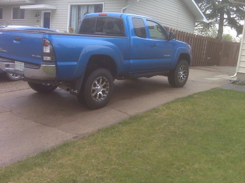

    I just recently put 17s on my 06 Tacoma so ya it will work. Just have to find the right ones. I used a 265/70R17 BFG A/T.
