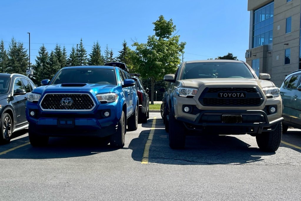

    255/85/16 Wildpeaks AT4 would do the trick. They also come with the 3 peak snow designation if that helps...
    This is what 33" Wildpeaks, and a 2" Lift looks like.
