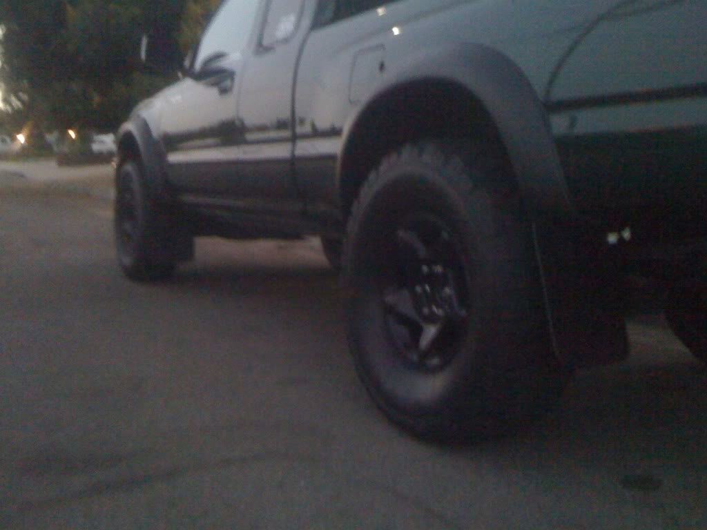

    OK this might sound really stupid but i got a set of big mud tires gave to me the other day and just tried them on the back ,fit ok but im sure the front dose not have the room to clear everything. So what im getting to is ,whats all the bad crap that can happen with driving with a/t in front and some biggg mud tired in back.. and just lay it all on me iv looked this up for 4wd trucks and from what i read its a really bad idea but mines 2wd so idk if thats better:confused:.

    It won't hurt anything. The reason you don't do it on a 4wd is because when locked in 4wd your front wheels would spin faster than the back causing the transfer case gears to get damaged. The only way it would hurt a 2wd is if you put a big tire on one side and not the other.

    grate thanxx thats what i thought but i didn't know for sure ,but i think i will keep it for a few days to try it out.. i was driving to work this morning and kinda started liking the way i felt but we will see (08
