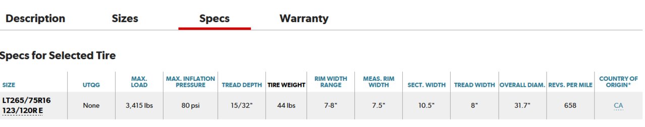

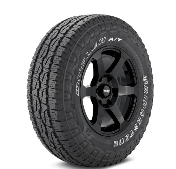

    I suppose though I am looking for a unicorn tire. 75% of the performance, looks, and security of the BFG with 25% of the penalty. I even thought of the Dueler AT Revo in the larger size. Seems good as an E rated at 44 lbs. Tread is a bit more oriented for the street, which is not a bad thing..and I think (E rated) the durability is there:
