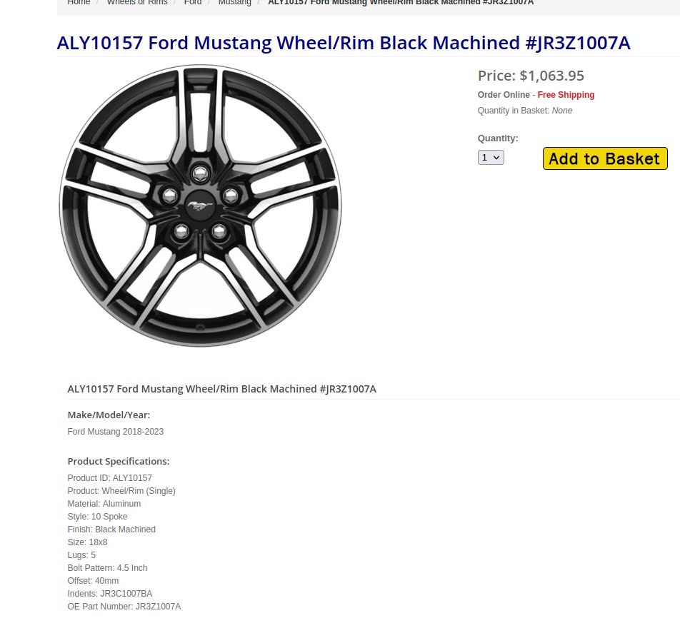

    That looks like the center of an OEM rx300 wheel. I don't know of any OEM rx300 wheels that was 19x10 from the factor :)
    What much to get that done? There's some of center of rims I like with the correct bolt pattern but the offset and width is not right for the S-runner.
    What are specs of the wheels, tires, what much negative camber to get it to fit up front?
    Looks good. much better than the mustang wheels I am now running.
    P235/50ZR18. I can use much bigger tires. There's a on ton of space in the back of wheels. on the front side maybe another 25mm if I wanted to be flush.
    Make/Model/Year:
    Ford Mustang 2018-2023
    Product Specifications:
    Product ID: ALY10157
    Product: Wheel/Rim (Single)
    Material: Aluminum
    Style: 10 Spoke
    Finish: Black Machined
    Lugs: 5
    Bolt Pattern: 4.5 Inch
    Offset: 40mm
