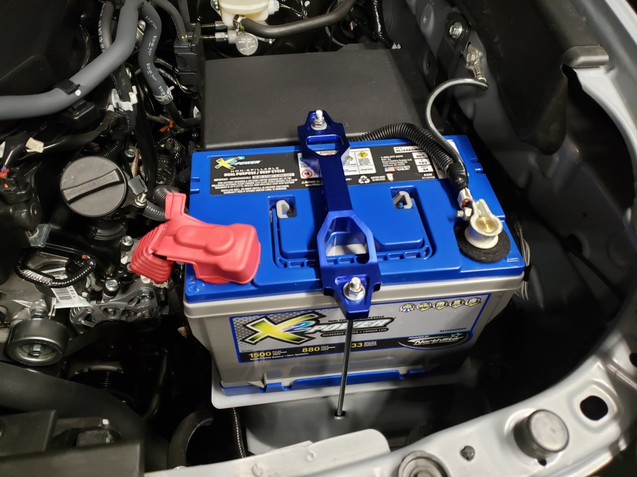

    My X2Power AGM battery by Northstar arrived at my local batteriesplus.com store and I installed it:
    This is their group 34 size with 880cca, cost $288 before discount and rebate. The fit was pretty much the same as the factory 24F except the terminals were on the opposite side. The battery did come with a bottom lift spacer which worked perfectly withe the factory tray. I added 3/8 wire loom to the cables as a precaution to any rubbing issues. Replaced the factory clamp with an anodized clamp from Amazon with new j bolts.

    I think 34f is with the terminal on the other side.

    No 34F model offered. I only found a 34 and 34M but no 34F on batteriesplus.com. The Northstar X2 34M has the terminals on the same side as their 34 and many of the Odyssey batteries are the same. There is a 27 and 27F, 24 and 24F however.
    Not a big deal since the cables were long enough.

    thank you for that photo. Is that the factory 24 tray or did you replace with a 27 tray?

    Factory 24 tray.
