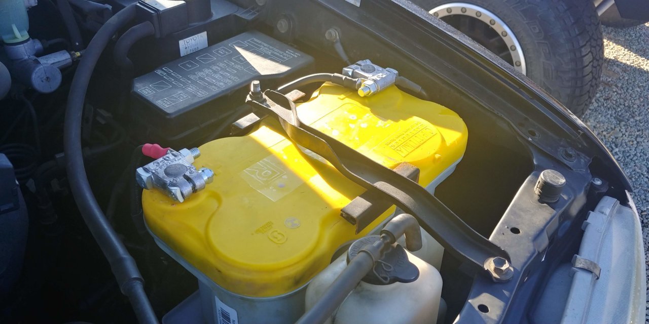

    I currently have a 27f in my factory location with zero issues. Plenty of clearance to everything. It's an Optima yellow top which I don't recommend. Look into Northstar, They are a very good company with a few of the engineers from Odyssey. 0324190855_HDR.jpg

    Did you replace the battery tray?

    Nope, it is the same height as the factory group 24 and same depth, just wider so it fits without issue.
