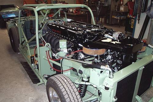

    Amatuer. Skin on a custom frame.
    How about a Jag v12 in a Miata? :D

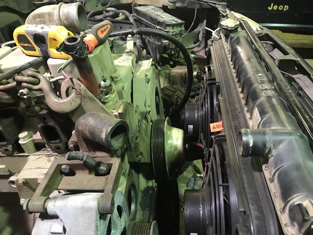

    98 4bt swapped on tons and 43’s
    My 4bt Cummins is tight length wise and I had to put a 1 inch body lift on it to use the stock hood. Anything bigger length wise you’ll have to either stretch the front or put the radiator and everything in your bed. It’s even tight side to side with the turbo/ piping on the passenger side and really tight on drivers side with the brake booster, master cylinder and fuse panel.. you can make a 7.3 fit but you’ll have to completely reconstruct the front of the truck including the firewall.2AB0E286-885B-48DB-9FBC-E59DB7A8BBDD.jpg
