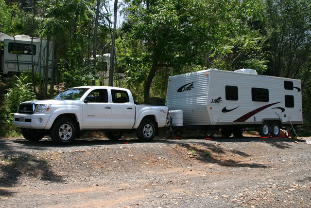

    Nice setup. 5700# though will actually be a bit of a struggle if you're planning on taking it to anywhere with any altitiude. Don't load anything in the bed of the truck either with a trailer that heavy or you'll be over your truck GVWR.
    The Tacoma is a more capable truck than many give it credit. I have a 26' travel trailer (yours looks to be about 28') that weighs loaded about 5200#. Getting into the 4000-5000 ft range in the mountains round here and you'll feel the loss of power. The V6 is strong but you'll have to let it rev to keep going on a good grade. I'm definitely happy with my setup though and have been pulling my trailer for 4 years now. The kids are growing though (now 6 and 3 years) and they're ready for some longer trips. I'm looking to trade up to a Tundra at this point though.
    FYI -one other thing to think about. Bring a 5 gallon gas can with you. With only a 21 gallon fuel tank and about 8-10mpg towing that thing you might just find yourself needing fuel before you reach the next station. Hasn't happened to me yet but I've come close.
    Good luck and happy camping. Definitely a nice trailer and setup.
    Here's my setup:

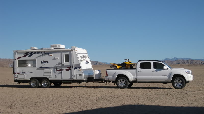

    Mine is not as long, but just as heavy. It weighed in at 6020 on my last trip, and i was 10,150 GCWR on this trip. I pack kind of light, just what i need.
    I second the gas can in the bed. I have almost ran out of gas once when heading to Glamis. I had a serious head wind through Palm Springs, and i was getting 5mpg's and could barley hold 50. I pulled over and dumped the 5 in to make it to the gas station.
