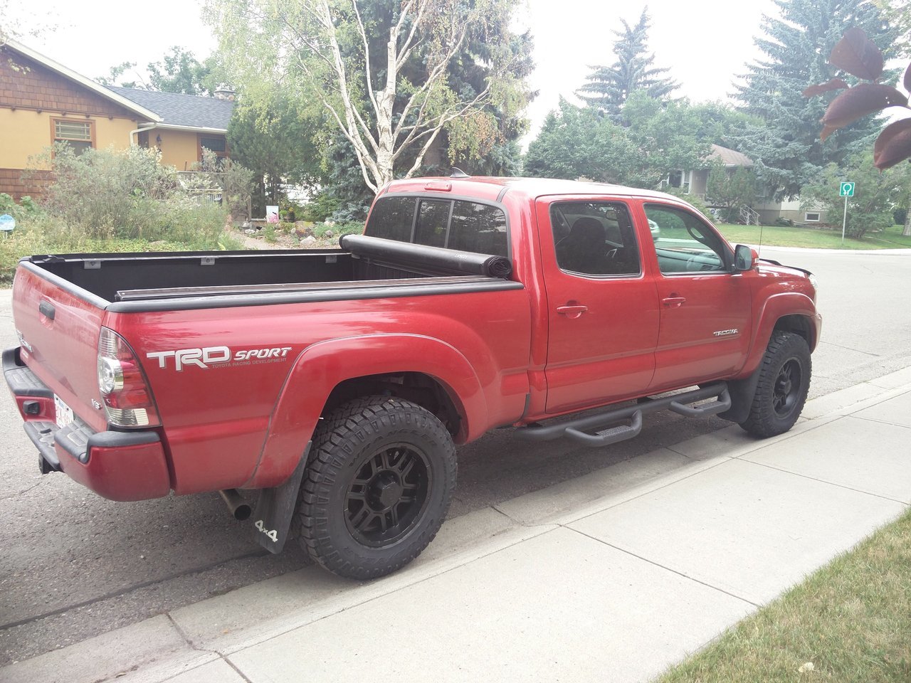

    Penz83
    Penz83 Well-Known Member
    Sep 2, 2012
    #86072
    183
    05 Tacoma pre runner dbcb short bed
    Here is another view. 265/70/17 2.5" I'm front 2" in rear ImageUploadedByTapatalk1374552744.583124.jpg
