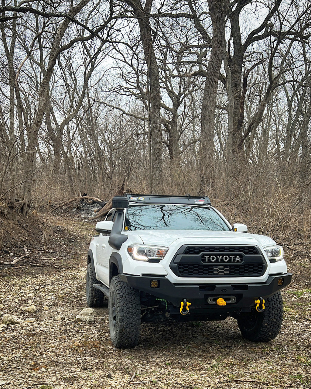

    I’m on a 1.25” spacer, 285/75r16, 2” lift in the front, and 1.5” AAL in the rear.
    It’s a good tire size and have served me well but I’m probably going to go 315/75r16 next. Always the hunt for a bigger tire :annoyed::D

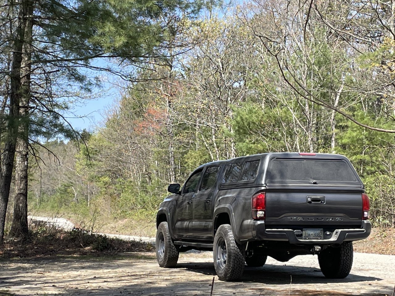

    I have a 1.5” lift up front and rxts on option 1 out back. Sitting on 255/80r17’s on 17x8 -10 I haven’t noticed them rub at all.
