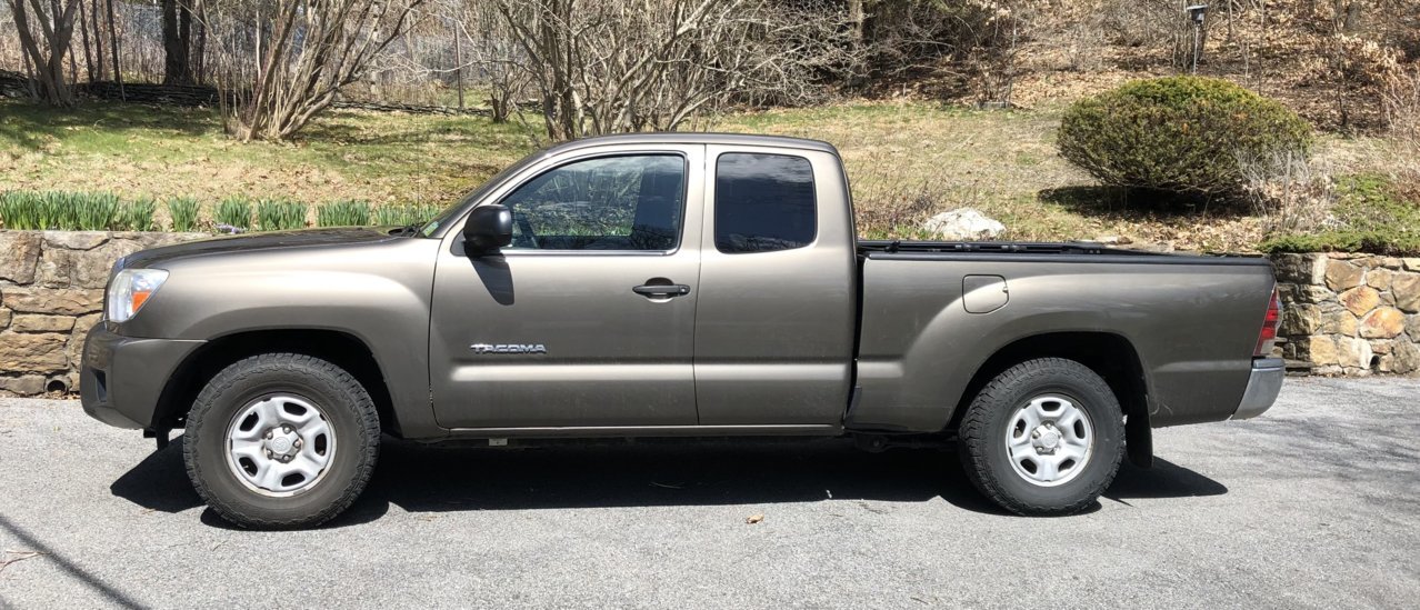

    235/75R15 fits stock wheels no problem.
    Here they are on my 2013.

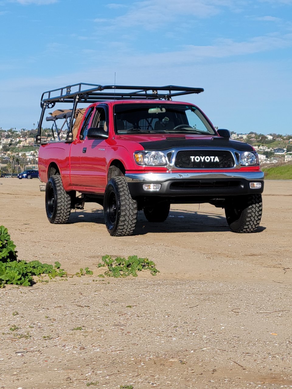

    Here's 235/75/15 on my 1st gen. I do have 3 inch lift spindles, but like other members have said they will fit no issues without a lift.

    lilred5lugger what's done to your truck it looks high af besides the 3 inch

    The front has the fabtech lift spindles and a one inch steel spacer I found on ebay. 4 inches total
    The back has the fabtech shackles, 2 AAL springs, and I also installed Air Lift air bags for towing and carring stuff on the ladder rack or when we load up to camp

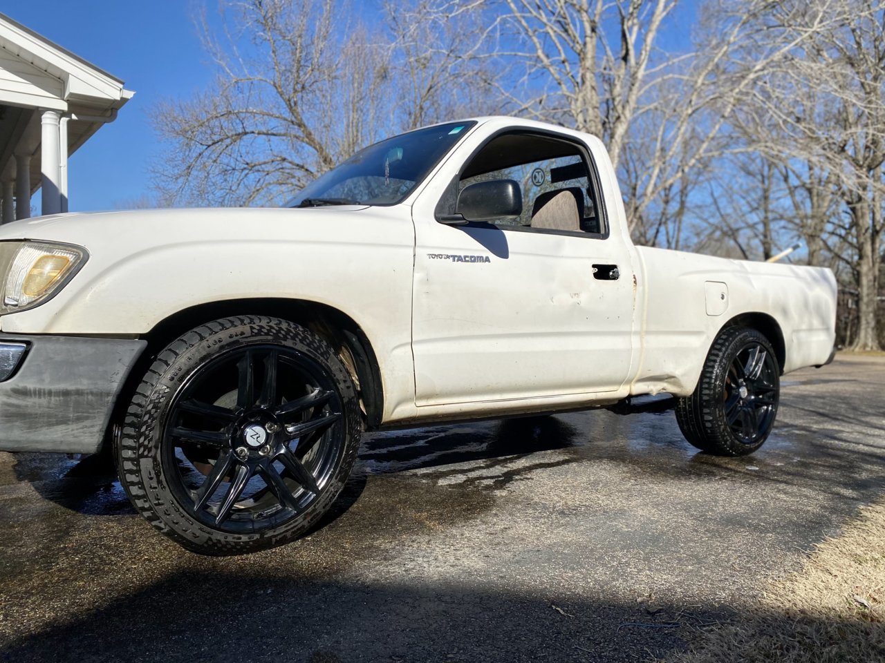

    what are you wheel specs?
    19 diam; width offset and back spacing?
    Is the center bore 67.1 ?
    Does it rub?
    thanks

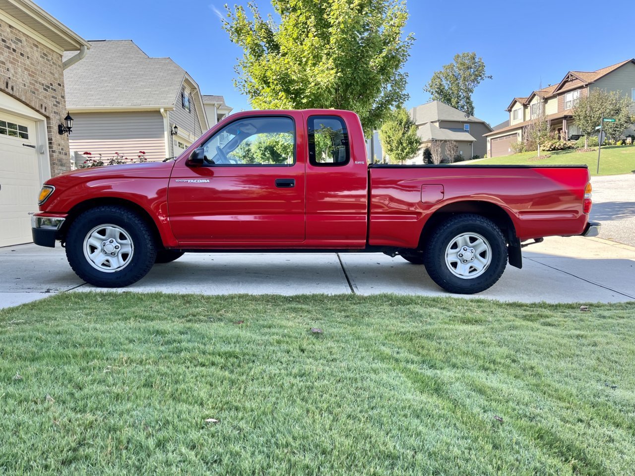

    235/75r15 tires, Wet Okole seat covers

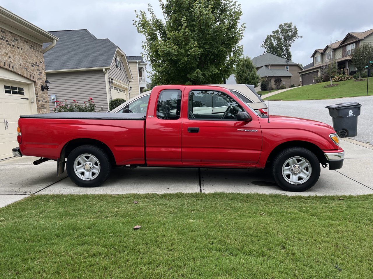

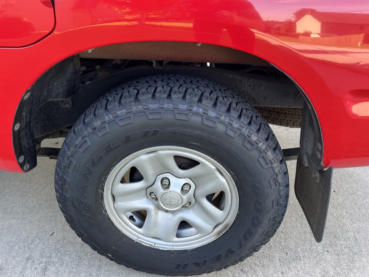

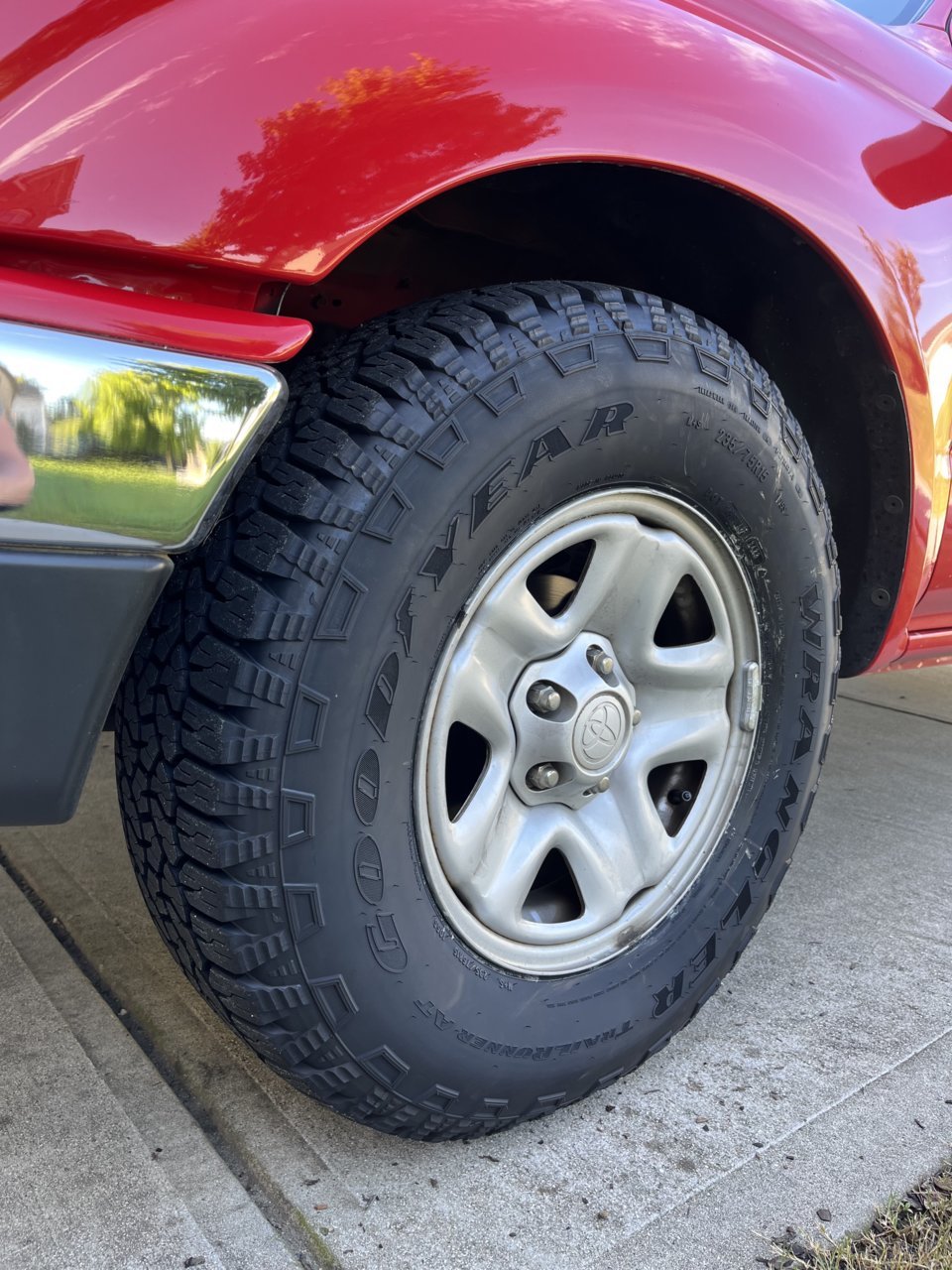

    I have a 2001 5-lug Xtracab no lift and was stressing over this decision for about a year (worried about rubbing, etc.). I ended up biting the bullet one morning and got the 235s and couldn't be happier. No rubbing, drives better (no power loss at all), and I get a 1-inch lift out of it too! Here's the before and after:
    Before:
    After:

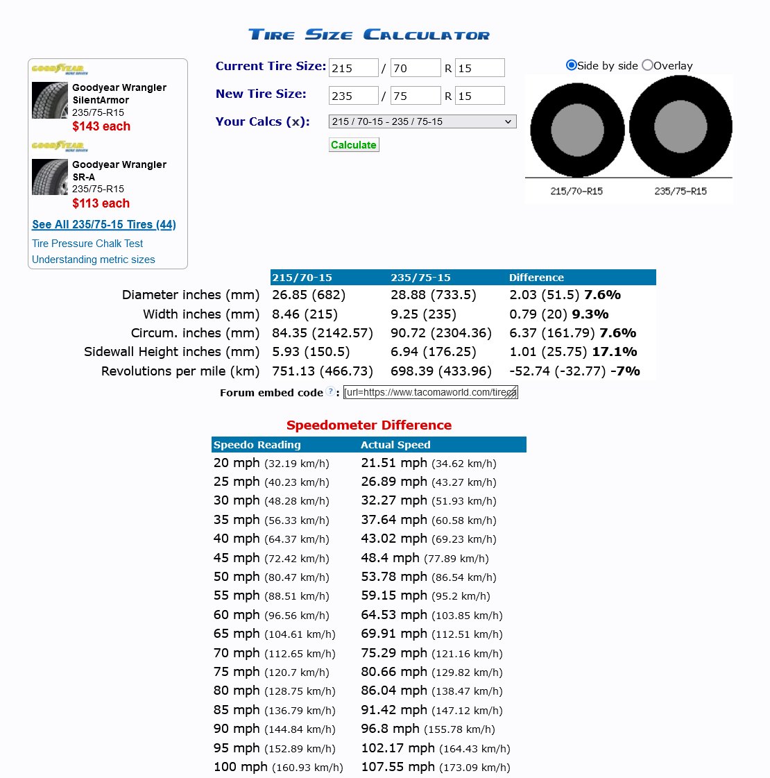

    I did not regear.
    If there is a slight power loss I don't notice it.
    You do have to remember that your speedometer and odometer will read lower.
    Just remember at highway speeds you are actually going about 5mph faster.
    Also, your mpg will be higher than indicated, so you're not getting worse gas mileage because of the larger tires.
    See the attached graph for differences.
    Screenshot 2023-11-18 at 12-33-44 215_70-R15 vs 235_75-R15 Tire Comparison.png
