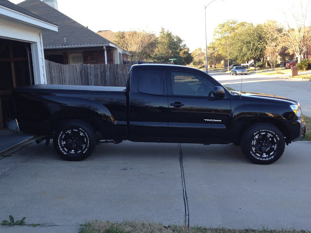

    Just got brand new 235/75/15 BFG All Terrains with MB Chaos wheels, major improvement from stock!

    wow west that looks good.i am not usually fan of black wheels but those look good.
