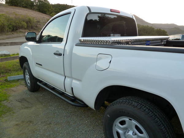

  11. Dec 30, 2013 at 1:33 AM
    #91
    aggiepack
    aggiepack Well-Known Member
    Sep 21, 2010
    #43582
    111
    Nate
    [**SOLD**] '08 Super White reg. cab waiting for the '16
    Fat Bob's 5 lug 2."75" Lift Kit, Fat Bob's Performance 8000 Rear Shocks, 235/75/15 BFG A/T tires, UWS Low Profile Tool Box, AVID Off Road Sliders, Chrome Grille Assembly, Fog Lights, Black badges, Tinted Rear Window, TRD Bed Mat, TRD Off Road Floor Mats, Maglite Mount, CoverKing Seat Covers
    @biker105 here's my 08 with the readylift kit and 235/75/15 with the stock rims.
    They will not rub even without a lift. If you go larger you're gonna have to do the black box mod. I had 225's before the 235's and I can tell you for a fact that the 235's look AND feel better.
    Here's a picture from the rear. You can tell they fill the wheel well a lot better than the stock 215's, but I've seen stock's with 245s and they fill a bit nicer imo. Honestly, I sometimes wish I went 245's for the little difference in height and fill alone, but I am more than content with the 235's. I think it was also mentioned before, but with the 235's and a readylift kit (spacer and an extra leaf) your speedometer will be just fine. Parked next to a prerunner without any mods, they barely and I mean barely, sit a bit lower looking from the front.

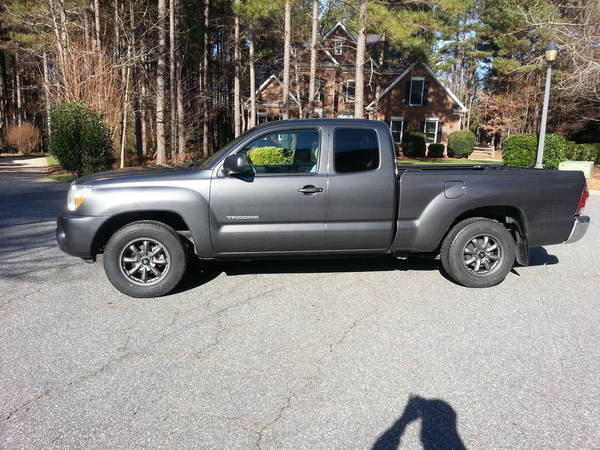

  14. Jan 16, 2014 at 6:29 AM
    #94
    320BusDriver
    320BusDriver Member
    Dec 27, 2013
    #119298
    17
    Kevin
    Mooresville, NC
    2010 Tacoma Mag Grey
    Wheels,tires
    This is a picture of my 2010 Access Cab with 16" Enkei Wheels and 235/65/16 Firestone Destination LE2's. (package deal from Tire Rack). Truck sits 1" taller, speedo now correct (was about 5% fast before), wheel wells filled out nicely and truck runs smooth on the new setup (Tire Rack does road force balancing). Mileage about the same when I factor in the odometer difference, avg 23mpg. Youd don't need to go all the way to 235/75's to get a nice look.

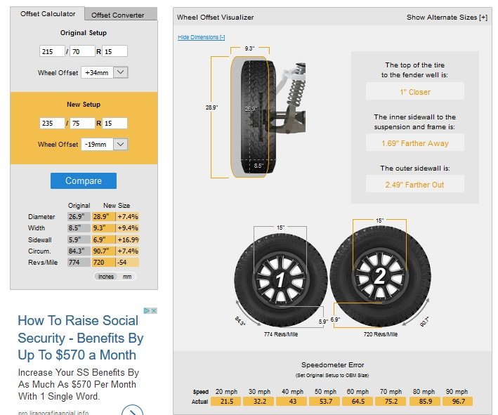

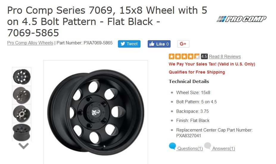

  18. Jan 8, 2018 at 12:19 AM
    #98
    Geronimo1111
    Geronimo1111 Well-Known Member
    Sep 24, 2016
    #198162
    345
    Ventura, Flagstaff & Phoenix
    '07 Silver Streak Mica 2.7L AC
    Ride-Rites LEER 100 XQ Cap Homemade Bedslider Bilsteins
    Our current tires are wearing down and we are planning for a trip down to Baja with our '07 2.7 2wd AC daily driver w/ 132k on it...we need new tires for bad roads and some offroad sections...:mudding:
    We are considering upsizing from stock 215 70R15s street tires to 235 75R15s ATs.
    Will the 235's fit?
    We understand it would throw the mileage and speed off a bit and could probably live with that...also a little less torque, a bit heavier, a bit less gas mileage...did we miss anything?
    1" more clearance...other positives to going bigger except looks? Roll over obstacles better?
    Any other issues we should be aware of? :confused:
    We are leaning towards BFG KO2s after looking at Falken Wildpeak AT3Ws, MT Deegan 38s, Yokohama Geolandars and Bridgestone Revo AT2s...mainly because my wife feels more comfortable buying tires at Costco (and the others - except for the Bridgestones - aren't carried there) and the BFGs look pretty bulletproof. She doesn't want to get stranded on some Baja backroad. LT metric C rating on those...$70 off a set of 4. We plan on buying 5 since the spare is a street tire and old and apparently dryrot is a thing here in Phoenix.
    Opinions on tire brand and size choice? :help:
    We also purchased five (one for the spare) 15 x 8 wheels on Lance's (Toyota expert at 4 Wheel Parts) recommendation. Apparently, he is on this forum and is aware of the brake caliper issue...He mentioned that these would clear the brake calipers whereas none of the aftermarket steelies that they carry would. We probably would have liked the look of 16" wheels better, but the price went up quite a bit for those (and the tires, too)...so we stuck with the 15's and got 'em for 20% off, no tax, free shipping... -19 offset.
    I think the stock steelies have a +34 offset...someone please correct me if I'm wrong...if that's true the new wheels will bump the tires out about 2.5 inches...which is what we wanted...:fingerscrossed:
    Are we in the ballpark on our thinking here? Any suggestions to improve the scenario? We've already given it a lot of thought, but don't want to make a bonehead mistake that others could easily see... Mahalo.:thumbsup:
    p.s. - One reason we were looking at the Falken's is for their $50 less per tire price and snow rating. We may go up to snow country occasionally, but it's not really on the radar at the moment...and not the primary concern...just nice to have the option of a tire that will perform well in the snow...:rolleyes::redxfall:
