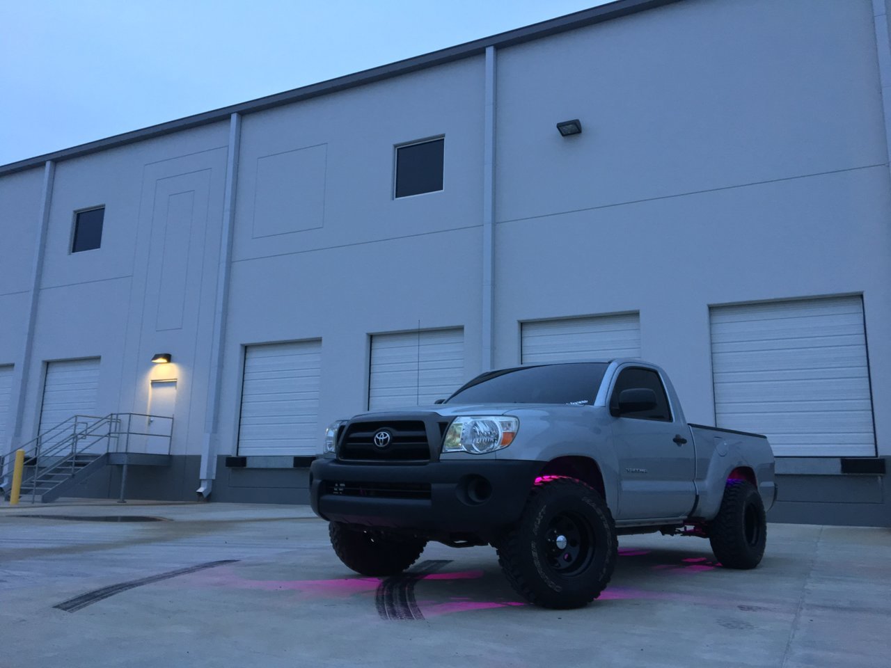

    4C36B67D-F2BC-490D-9988-8D879FA37EFF.jpg 31x10.50s just did the black box mod
