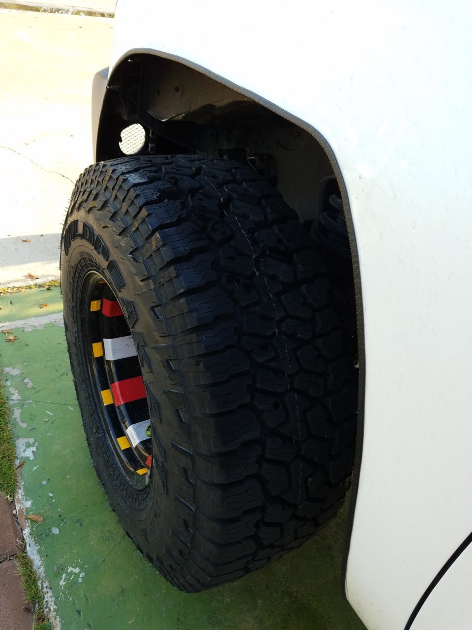

    I got Falken Wildpeaks A/T

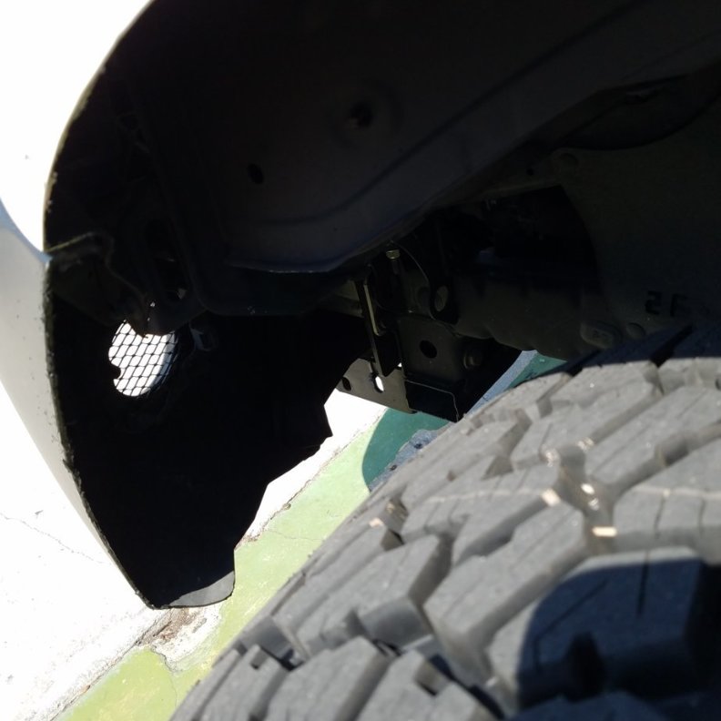

    The 30x9.50r15s are bigger than the 235/75R15s, right?
    I definitely had rubbing with the 235s...others reported there wouldn't be any, but there was. I was kind of surprised by that. It may be the brand of tire...KO2s in this case on a 2nd gen. 4 banger.

    Where were you Rubbing?

    On black boxes...at close to full turn. Maybe at 75%...

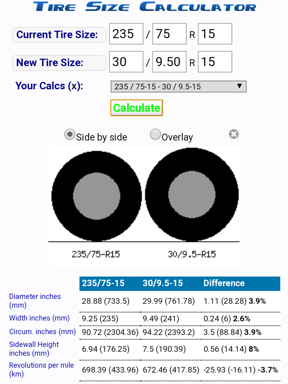

    Why not just remove them, im pretty sure everyone that has told you they don’t rub Proably has removed the black box. Also 235x75x15 is practically the same as a 30x9.5 its like 30.9x9.3

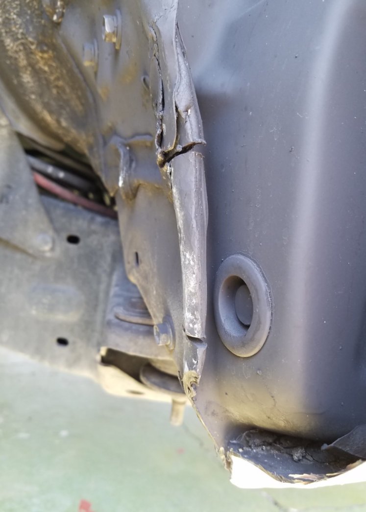

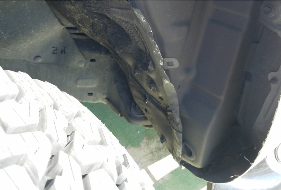

    I use to run 255/70r15 and 275/60r15.. I had 30x9.5r15 Absolutely no rubbing at all with that box taken out.. I ran 31x10.5r15 and I had the fenders bent from hitting the center everytime I hit a bump.. So I managed to take all of the plastic out and bend that metal strip in the back part along with cutting my fenders on stock height and fit 32x11.5r15 on 15x10 rims lol .. I went all the way

    "Practically" is a relative term. It is actually not like 30x9x9.3. It is 28.9" x 9.3 x 6.9...so a fair bit smaller. If the 235s are rubbing, the 30s definitely will rub worse.

    My bad on the size, when i used my tire calculator I left the rim size at 17”
