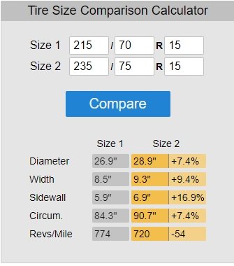

    Just got some Cooper Discoverer AT3's in 235/75/15. Gave me about 2 inches of lift. No black box mod yet, might look into it this weekend.
    Speedo reads ~5mph less than actual at highway speeds. Anyone try to correct the speedo and odometer with larger than stock tires?

    Stock wheels? That's the largest tire you can run with no bumping/rubbing and no modifications. But it only gave you 1" over the OE 215's. Yes, it's a 2" larger diameter, but the 'lift' is based on radius.
    Should not be needed unless you have aftermarket wheels with poor fitment.
    AFAIK it can only be done with a Hypertech Speedometer Recalibration Device Part Number: HYP730107

    Thanks for the info, Billy. Yes, they are the stock steel wheels and the truck rides much smoother now. I will look into that part.

    Just an FYI .. your total height gain is 1". Your tire diameter increased by 2" from OEM to upsize - you then divide that by half to get the difference in ride height.
    Black-box mod is really only needed if you start pushing tire diameter above 29.3" with no spacer/aal kit. You should be able to run as-is without removing them at this time.
    There are electronic 'speedo healers' out there - not a cheap solution at around $200.00 or more. The speed sensor is on the output shaft of the transmission, and counts rpm's of the driveshaft to calculate speed. A corrective regear to the final drive ratio that the new tires call for, would correct the speedometer mechanically.
    I am mildly overgeared, so my speedometer is still off.
