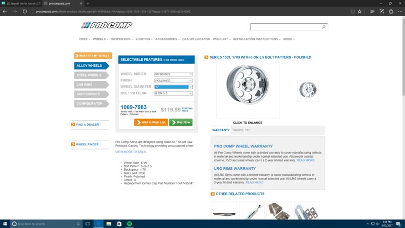

    I ordered these wheels 17x9 I already have a 3 inch pro comp lift just want to see what tire size I should go with
