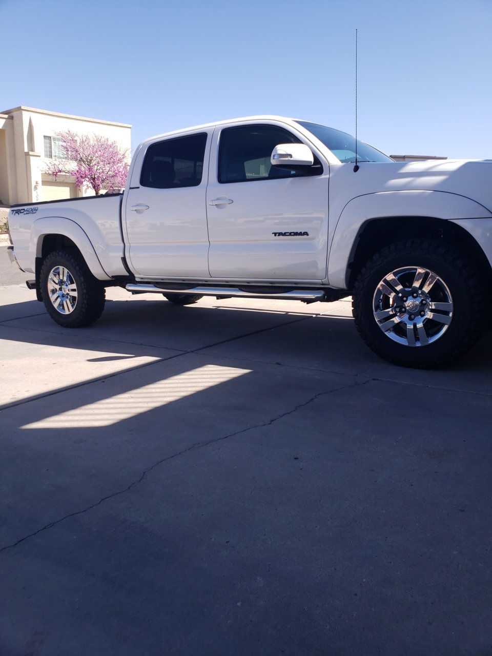

    I have a 2013 Limited so it obviously has those same wheels. I just did a Bilstein leveling kit yesterday. It put the top of the wheel wells at 36" all around. Today I had 275/65r18 KO2s installed. I have removed the mudflaps previously, but I have no rubbing and have not done any trimming. The tires look great and fill the wheel well nicely. I like the slightly larger size and higher profile of the truck. Hope this helps.

    Wow this sounds exactly like what I’d like to do. Can you share a pic?

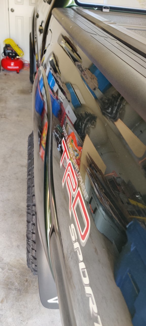

    Predator Tube Steps, Fuel Hardline Wheels, 265/70 R 17 Nitto Ridge Grapplers, 2 inch Rough Country Leveling Struts, Undercover Armour Flex Hard Folding Tonneau Cover, Pop and Lock Tailgate Latch With Key Lock.
    I did a 2 inch leveling strut, wheels and tires at a local shop called Pro Trucks. They have a guy thats a walking wheel and tire dictionary. He said I needed a 0 offset wheel and could go from the stock 265/65 R17 to a 265/70 R17 which is what I ended up doing. Gives me just about an inch or so of poke which I think gives it a good looking stance.

  13. Apr 10, 2021 at 6:59 PM

    Timred93 would you mind sharing a pic of your truck?

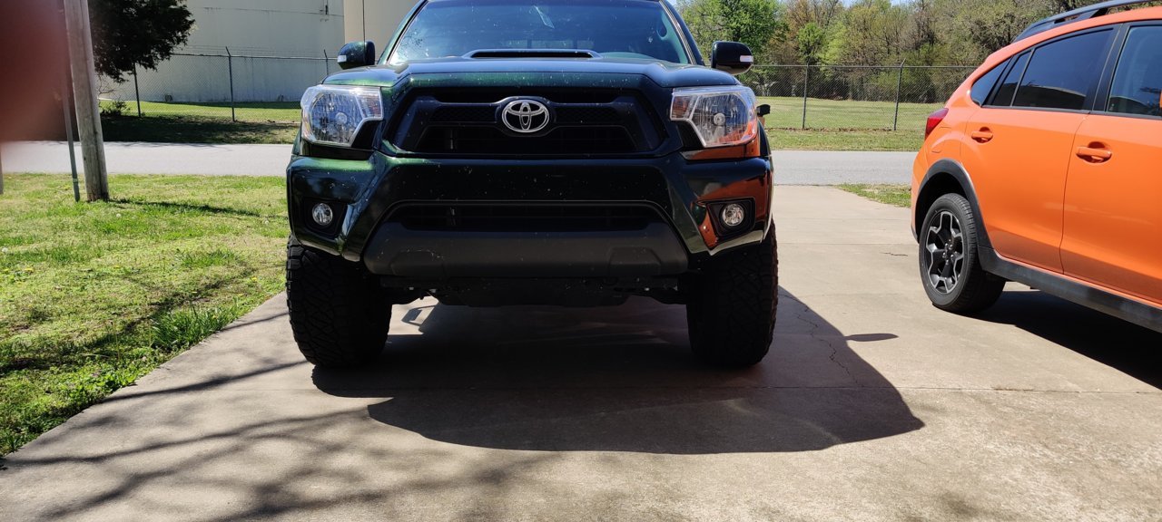

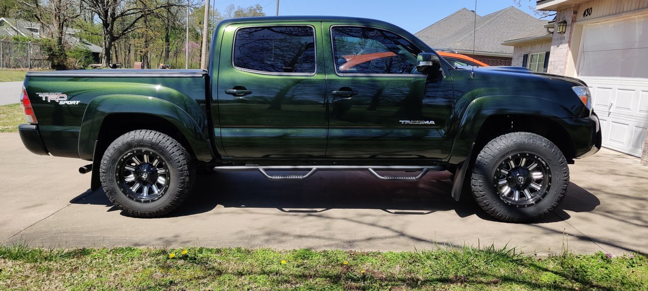

  19. Apr 11, 2021 at 12:48 PM
    #39
    timred93
    timred93 Never too old to Tacoma
    Feb 7, 2020
    #318553
    202
    Tim
    NW AR
    2013 Spruce Mica TRD Sport
    Here's a few shots of mine. Side view so you can see about how much poke they have, front and side views
