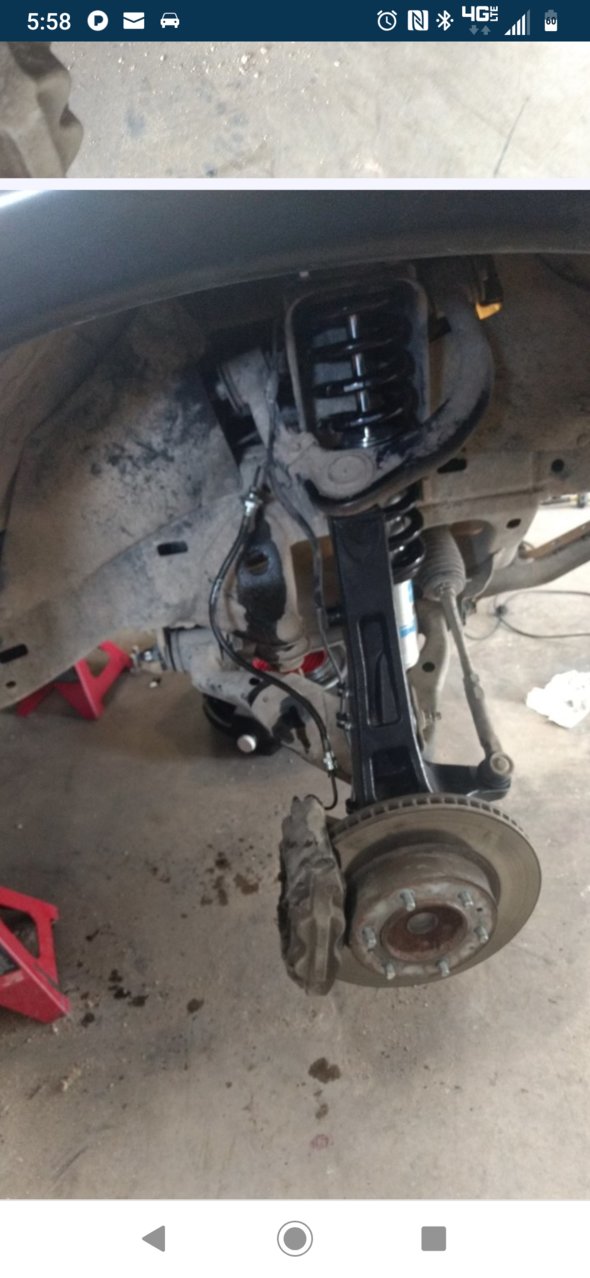

  13. Dec 5, 2019 at 3:59 PM
    #33
    05prerun82
    05prerun82 Your local friendly Taco Mule TTC#0202
    Aug 11, 2018
    #262485
    19,804
    Brandon
    Fredericksburg
    2006 aclb prerun
    Memphis sound system volant cold air intake
    See the maxtrac spindles are an inch and a half farther out than the factory spindlesScreenshot_20191205-175857.jpg
  14. Dec 5, 2019 at 4:01 PM
    #34
    Joey_Bada_Bing
    Joey_Bada_Bing Well-Known Member
    Dec 22, 2018
    #276643
    340
    North Carolina
    1st Gen DC 4WD
    A bunch of the same stuff everybody else has already done.
    And for what it’s worth I just did a 3” lift with 285/75/r16s (almost a 33”) all terrains, and I had to do some trimming, hammering. I still have a little more to trim/hit actually... if I had the same size tire in mud terrains I’m willing to bet it would be worse?
    05prerun82 likes this.
  15. Dec 5, 2019 at 4:01 PM
    #35
    05prerun82
    Aug 11, 2018
    #262485
    19,804
    Brandon
    Fredericksburg
    2006 aclb prerun
    I'm running the same size tire
  16. Dec 5, 2019 at 4:05 PM
    #36
    Joey_Bada_Bing
    Dec 22, 2018
    #276643
    340
    North Carolina
    1st Gen DC 4WD
    Man those spindles are sweet!
    05prerun82[QUOTED] likes this.
  17. Dec 5, 2019 at 4:07 PM
    #37
    05prerun82
    Aug 11, 2018
    #262485
    19,804
    Brandon
    Fredericksburg
    2006 aclb prerun
    They give you 4 in of lift and you keep your stock suspension geometry that's why I have factory upper control arms one day I'll upgrade them though
  18. Dec 5, 2019 at 4:11 PM
    #38
    jbrandt
    jbrandt Made you look
    Feb 12, 2011
    #51038
    17,612
    Justin
    El Dorado, CA (NOT El Dorado Hills)
    '04 TRD Tacoma 4x4 DC
    Kings, J59's Total Chaos UCAs Custom skids Sticker mod
    Oh I gotcha. I know you said spindles, I just had spacers stuck in my head, lol
    For the 1st gens, we don't have any lifts (except long travel) that push the wheels out like that. So typically if your wheels are pushed out, it's because of spacers.
    I think I'll have to refer you to the 2nd forum then. That's not a thing with 1st gens so I don't really have a solution for you except to cut where it's rubbing.
