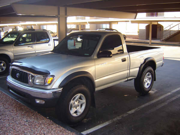

    Here's a pic of my old 1st gen with 265/75/16s for ya as well

    So yea... 31x10.5x15 if your running 15s or 265/75/16s if your running 16s :laugh:

    dude I ran 265/75/16s and had no issues at all...if you look up top you'll see the pic I posted of my old 1st gen...I even have the mud flaps on lol...
