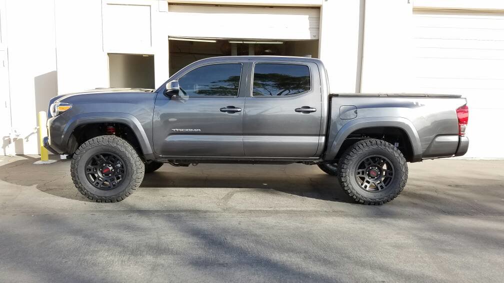

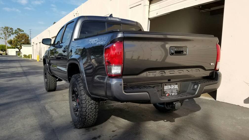

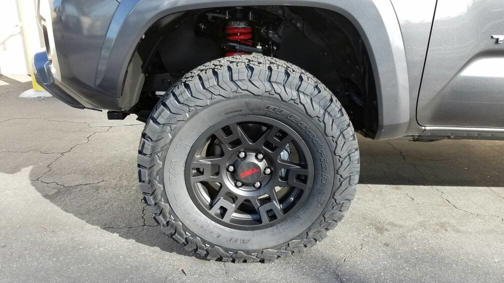

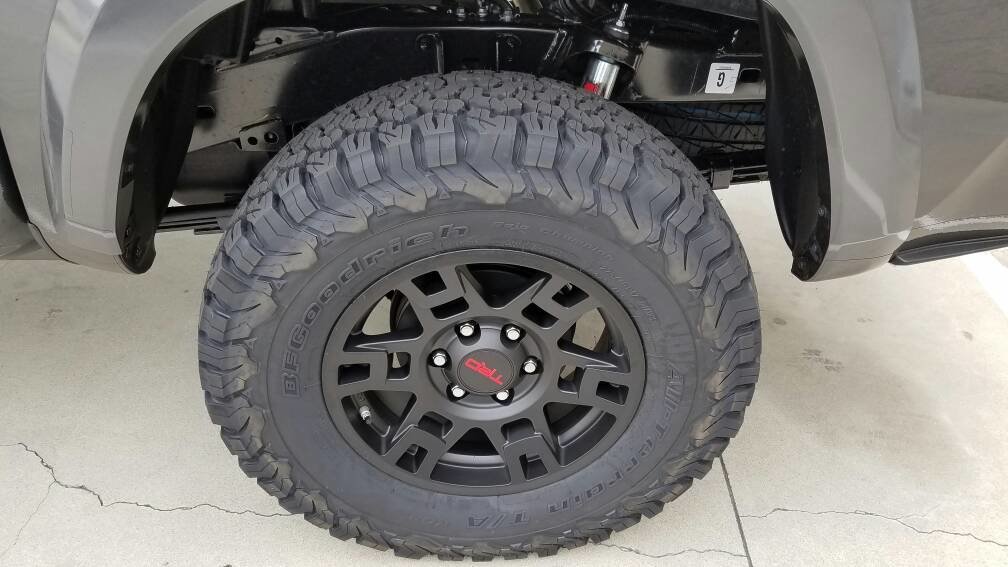

    I just got the Boss 2.0 lift and the 275 70 17 KO2's. 1 inch block in the rear. Rides great! Slight loss in power but not a big deal. Gas mileage is down about 1 mpg or so.

    Damn that looks good!
    Love to do the same to my Limited....
