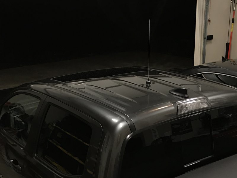

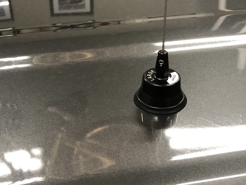

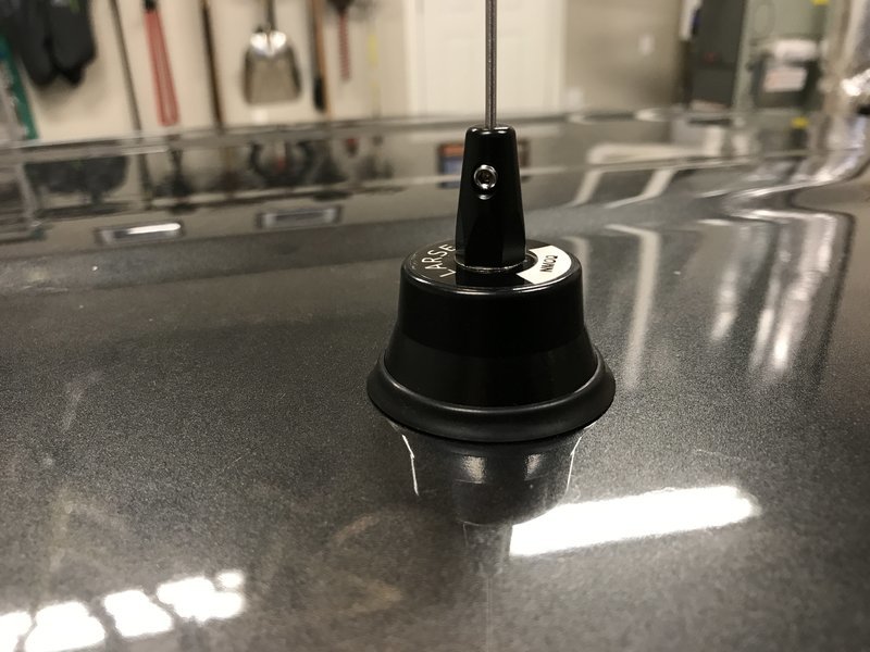

    Just finished cutting and tuning the Larsen 1/4 wave VHF antenna. I did roof mount it. Some have asked about these antennas. For roof mounts I like commercial products as they usually have a secondary seal. This uses their "Super Seal" gasket in addition to the standard O-ring under the NMO mount itself.

    For general repeater use, in town driving, and mountainous terrain, it is hard to beat a good old fashion 1/4 wave. So many of these companies advertise their "Super Gainer" etc. and have a bazillion coils and whirly twirlys to make the antenna look awesome, but on an analyzer and working tests they really are not good for general use. The more gain the further the signal, sure, but it goes straight out vs. up and out which kills you for hills, mountains and repeaters etc. AND they don't break off!

    ? You kinda lost me on that. You're wanting a higher angle of radiation as opposed to a lower angle? Did I misread that?

    Correct. For repeater use a higher takeoff angle is preferred which you get with 1/4 wave. I own three ham repeaters in Oregon.
