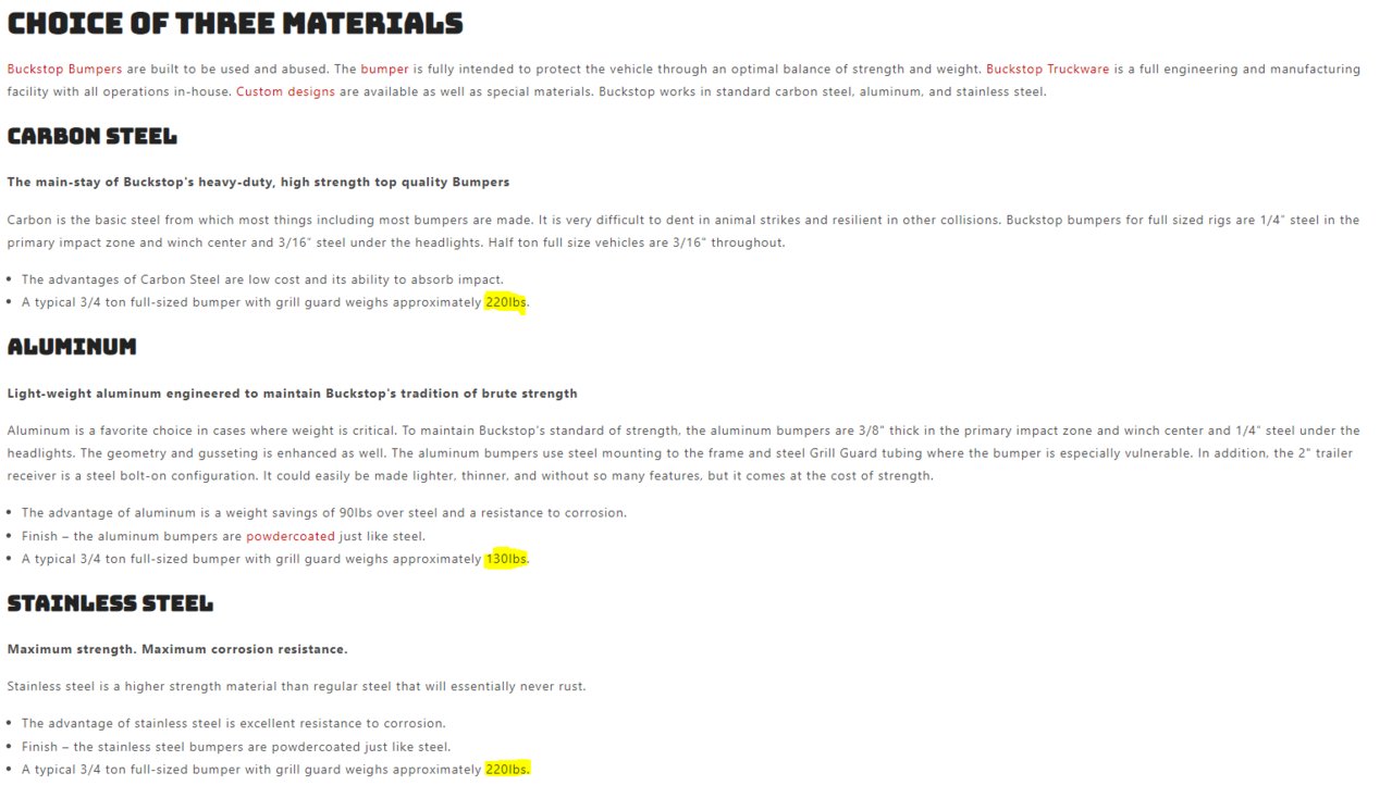

    I just checked their site, no matter which material it's made from, it's gonna be heavy (the one you chose is 220lbs, not 200):
