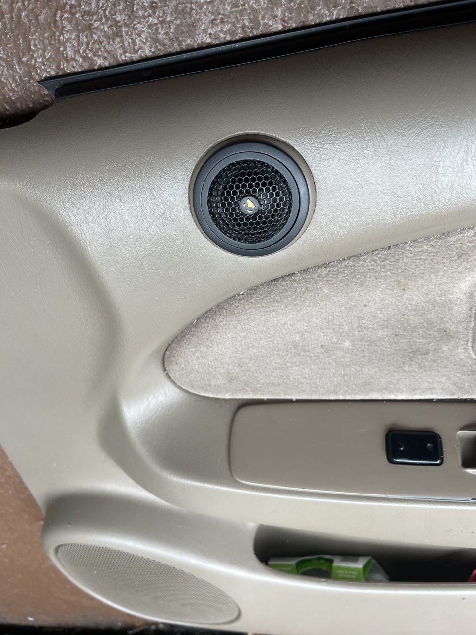

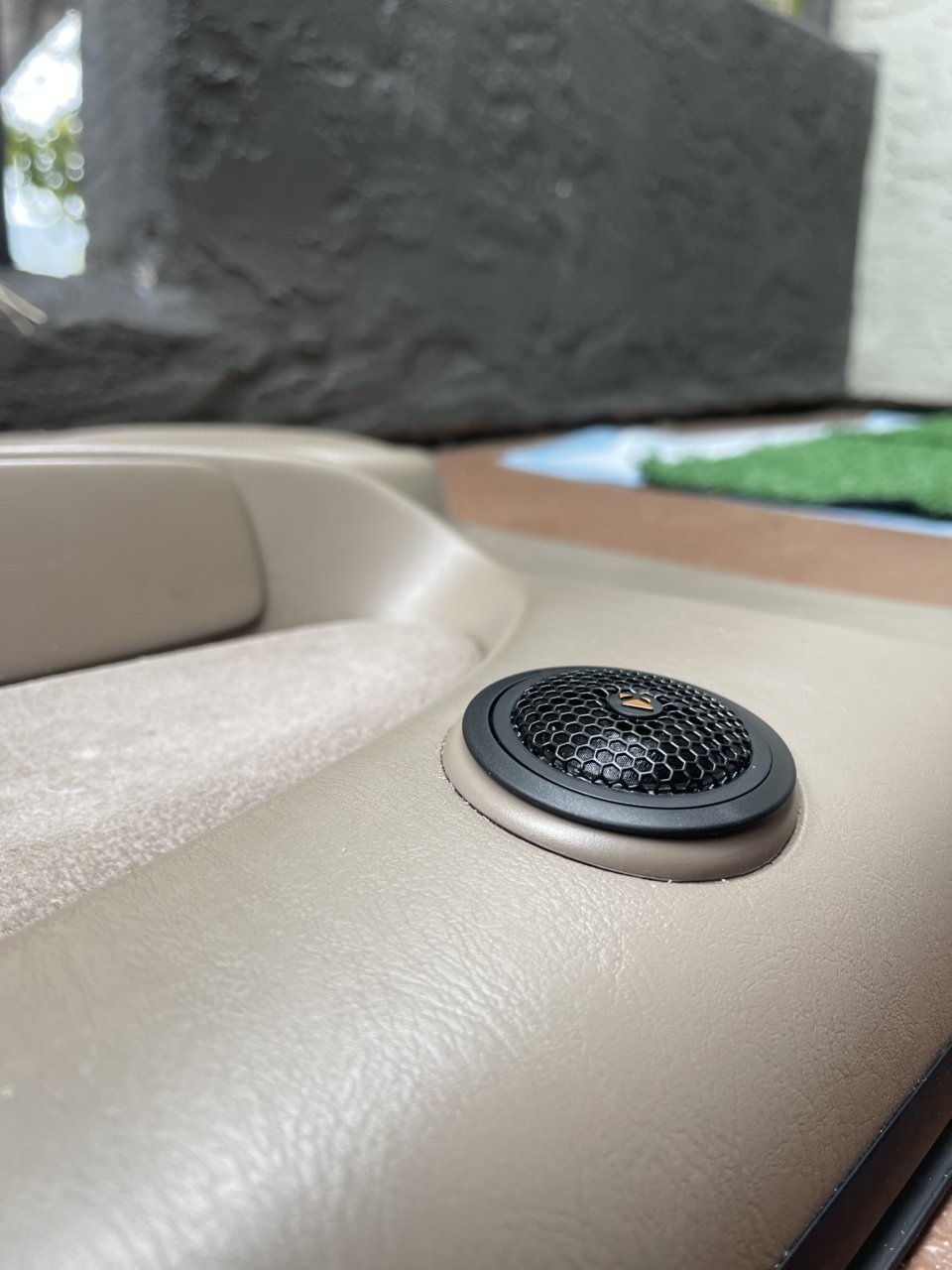

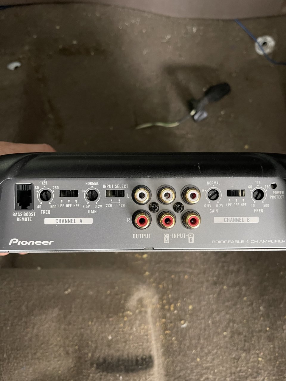

    So the new components came in and now I’m at the wiring stage. I’m a little confused on how to plug in the RCAs into the amp. Turns out my head unit actually only has two RCA female connections. So I had to buy two bridge cables.. does that make sense? Am I saying this right? I now I have 4 male ends like I believe I’m suppose to.
    If my head unit only has two female connections does that mean I only need two RCA cables (2 male ends to go into amp)?
    Again, I’m only doing the front speakers And tweeters which came with their own crossovers. Here’s a few pics.

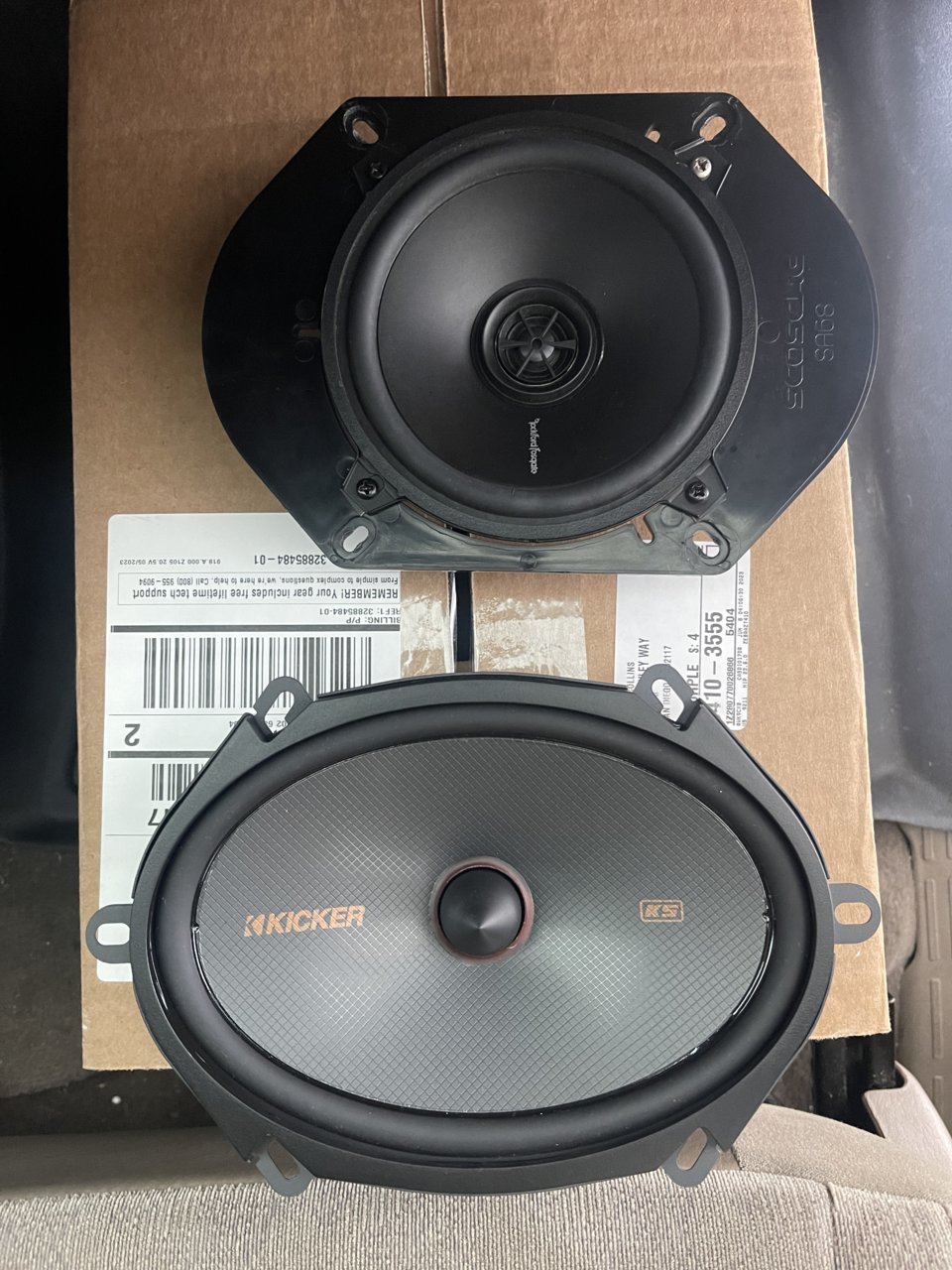

    Old vs new & tweeter install

    4 run, 2 don't
    Some headunits allow the ability to change said output to either low range (subwoofer) or with no filtering (full range).
    Check to make sure you can utilize full range as that's what you'll need for your new components.
    Since you're only doing fronts, that will be considered one left channel and one right channel IE only 2 RCA plugs total.
    Utilize channel A for said inputs and remove any filtering and just use your headunit for any adjustments for convenience.

    in this case, you only need 1 pair of male-end rca's from the head unit to the amp. you'll only be using channel 'A' of the amp. channel 'b' will not have any connections. as kwikvette said, make sure that the rca output is set to full range, or high pass, if possible. i know some 1-pair output radios only offer a subwoofer output-- this won't work in this case.
    where i differ from kwikvette is that i would recommend setting the amp crossover to 'HPF' for high pass frequency, and would set that to 40hz. the door speakers really can't reach much below 50hz anyways, so this step is done to protect the speakers from being pushed to far physically.

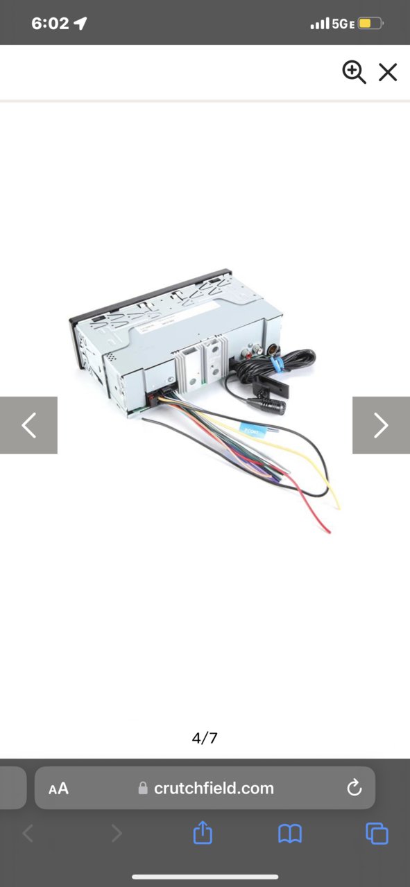

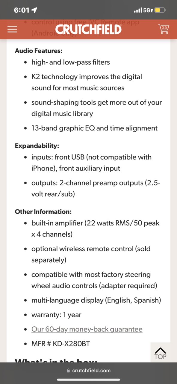

    https://www.crutchfield.com/p_105KDX280B/JVC-KD-X280BT.html?tp=5684
    Almost positive that this is the model head unit that I have, this one just looks like a newer design. Should still have the same specs right? Or could that have changed from when I bought it 4~6 years ago? I’m trying to find where it mentions full range in the specs info. Here’s a snapshot of the specs in case the link is dead.

    Almost?
    Stereo model is normally right on the front of the stereo.
    If you pulled it out to view the only 2 RCA plugs in the back, then it'll be in the back.

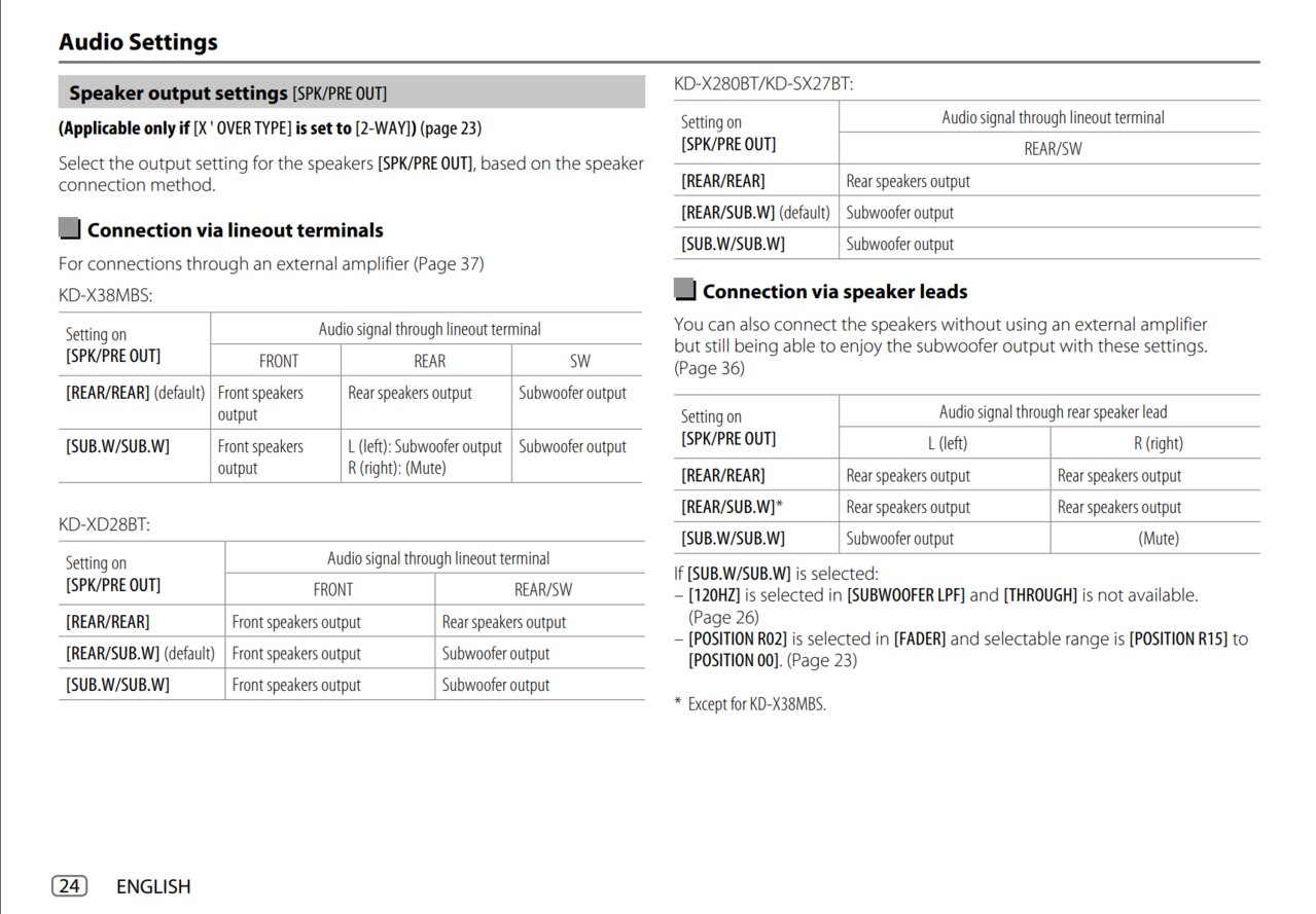

    Based on the model you posted, here's the page you'd want to check out -

    And how can I tell if my amp crossover is set to HPF and 40hz?? There’s only this adjustable switch that has 3 settings that I’m assuming are for low, medium, high.

    Based on that you should use REAR/REAR
    Odd to see an output on your RCA's to be considered Subwoofer or Rear when normally it would be either
    1. Subwoofer only
    2. Full Range or Subwoofer
    Specifying front or rear on a preamp signal out is just, odd

    Your amplifier will literally tell you what you are set at based on where you physically move your switch and/or dials.
    If there is no 'infinite' adjustment based on your 'low, medium, high' description, again that is where you refer to your owner's manual to see where it cuts off at.
    "Low" "medium" and "high" will differ between brands, as this is not standardized by any means.
    It's like telling someone to go fast, so they go 80mph whereas for me it'd be 160mph; see where I'm getting at?
