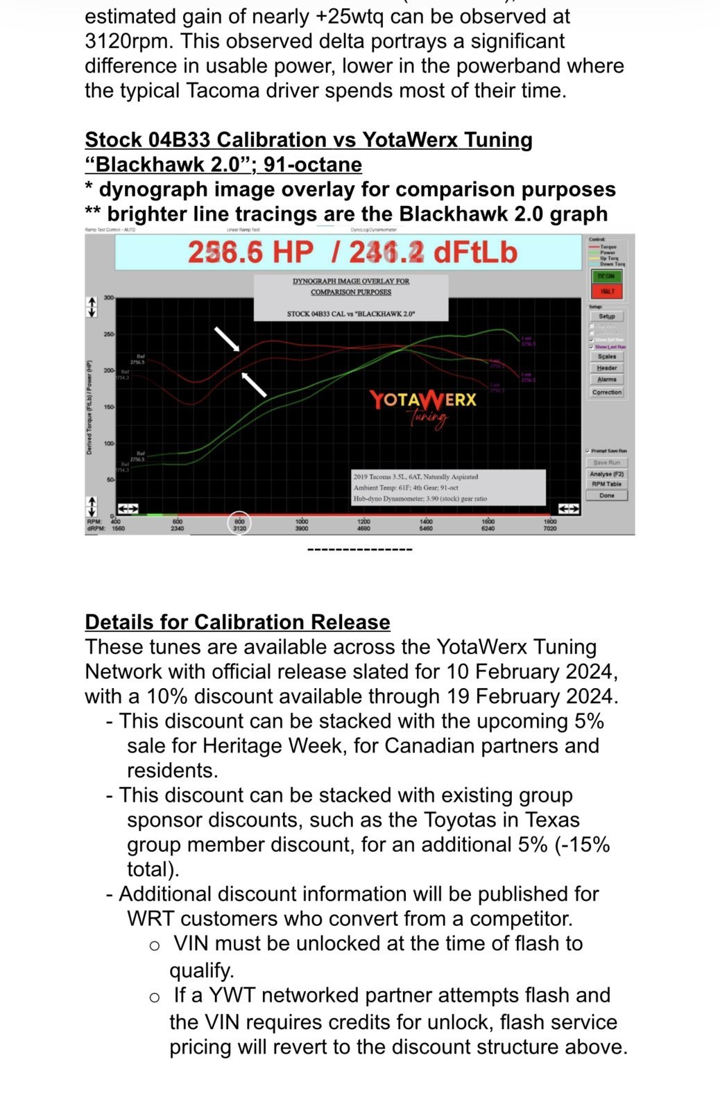

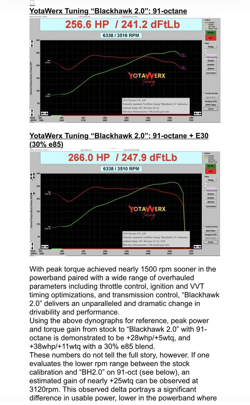

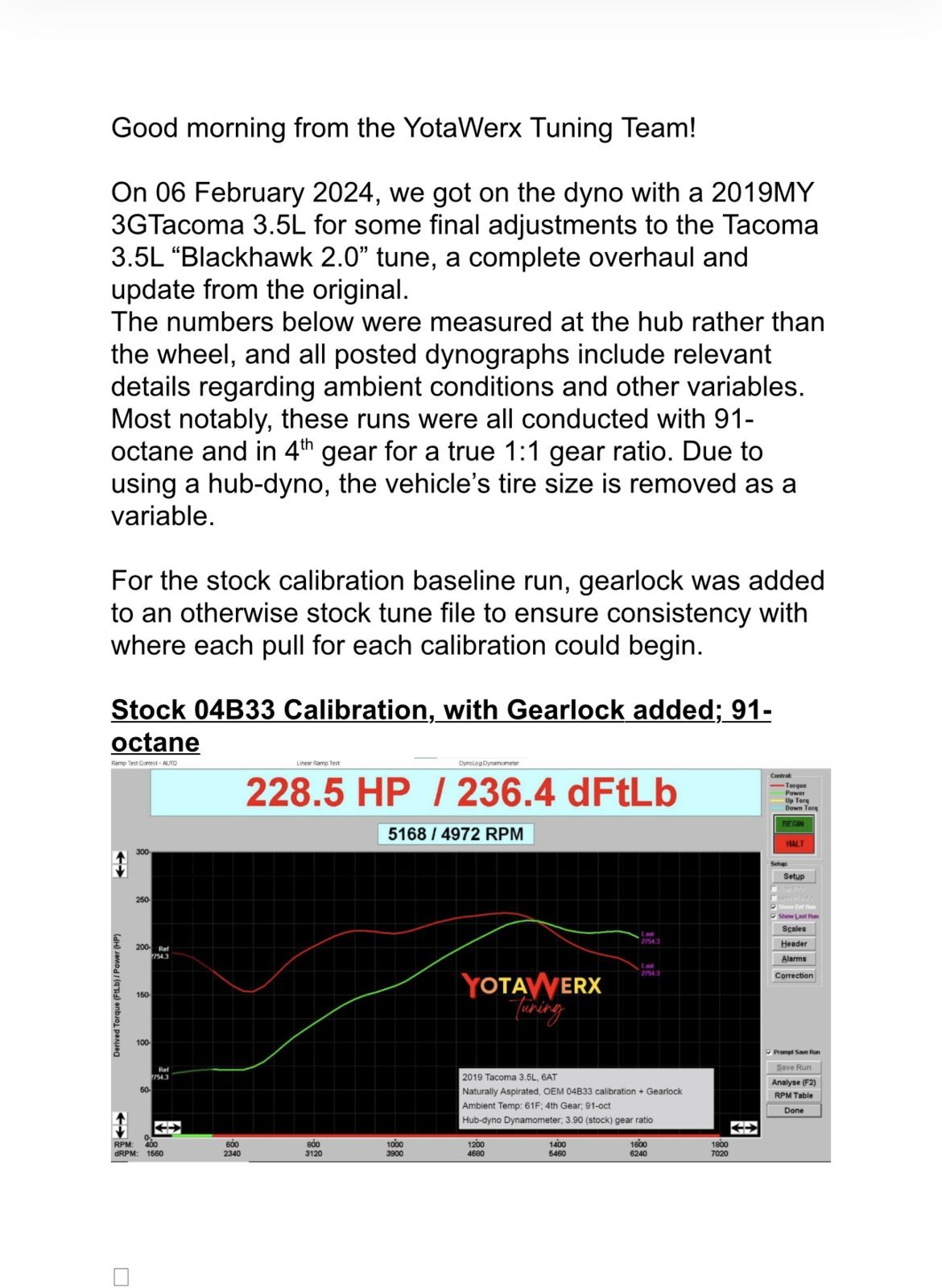

    Well since KDMAX has been acquired by YotaWerx let talk about their offerings. The latest release of BH 2.0 came out in February and further refinement's are soon to be released.
    Here are the Dyno reports from those test. These were performed on a hub Dyno removing tire size variable. The main thing on YotaWerx is pushing max torque down in the lower RPM. Range where needed.
    Where KDMAX did an excellent job of developing a balance tune where you had great HP, Low and Mid Range power-band. YotaWerx further pushes max Torque to 3120 RPM, stock peaks at 4800.
    This is real torque that can be felt and Dyno proven.
