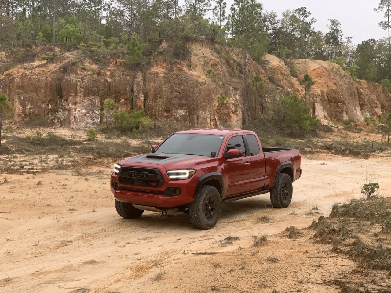

    Took delivery of a Barcelona Red Access Cab manual today. I have a long list of things planned for this thing. Already have diode dynamics yellow pro ss3 pods for fog lights. Waiting on a new shift knob from anarchy motive to arrive. And
    Xpel ceramic tint - Definitely need this ASAP in Florida
    Satin black hood and roof wrap
    Lift wheels & tires - I’m thinking Eibach pro truck lift with black 17x9 level8 mk6 wheels and 285/70/17 either cooper at3 or toyo at2
    Sso bumper with winch
    TRD PRO grille with Raptor style smoked amber DRLs
    Rock sliders just don’t know what brand yet
    Spartan customs Hidden bumper Led light bar and possibly scoop light
    Hard tri fold Tonneau cover
    lopro bedrack for roof top tent
    Rock lights
    Oem bed lights & mat
    Cat back Exhaust and Cold air intake
    Arb compressor in a expedition essentials mount
    I know there’s more I’m forgetting but I’ll update as I remember
    Leaving the dealer in Maryland on its trip to me in Florida
    Picking it up today
    When I got it home

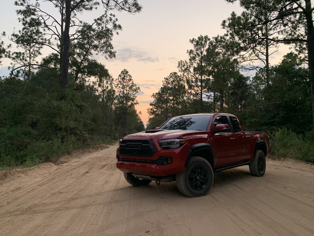

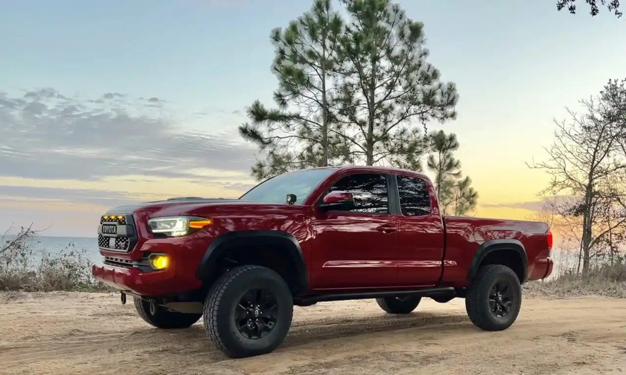

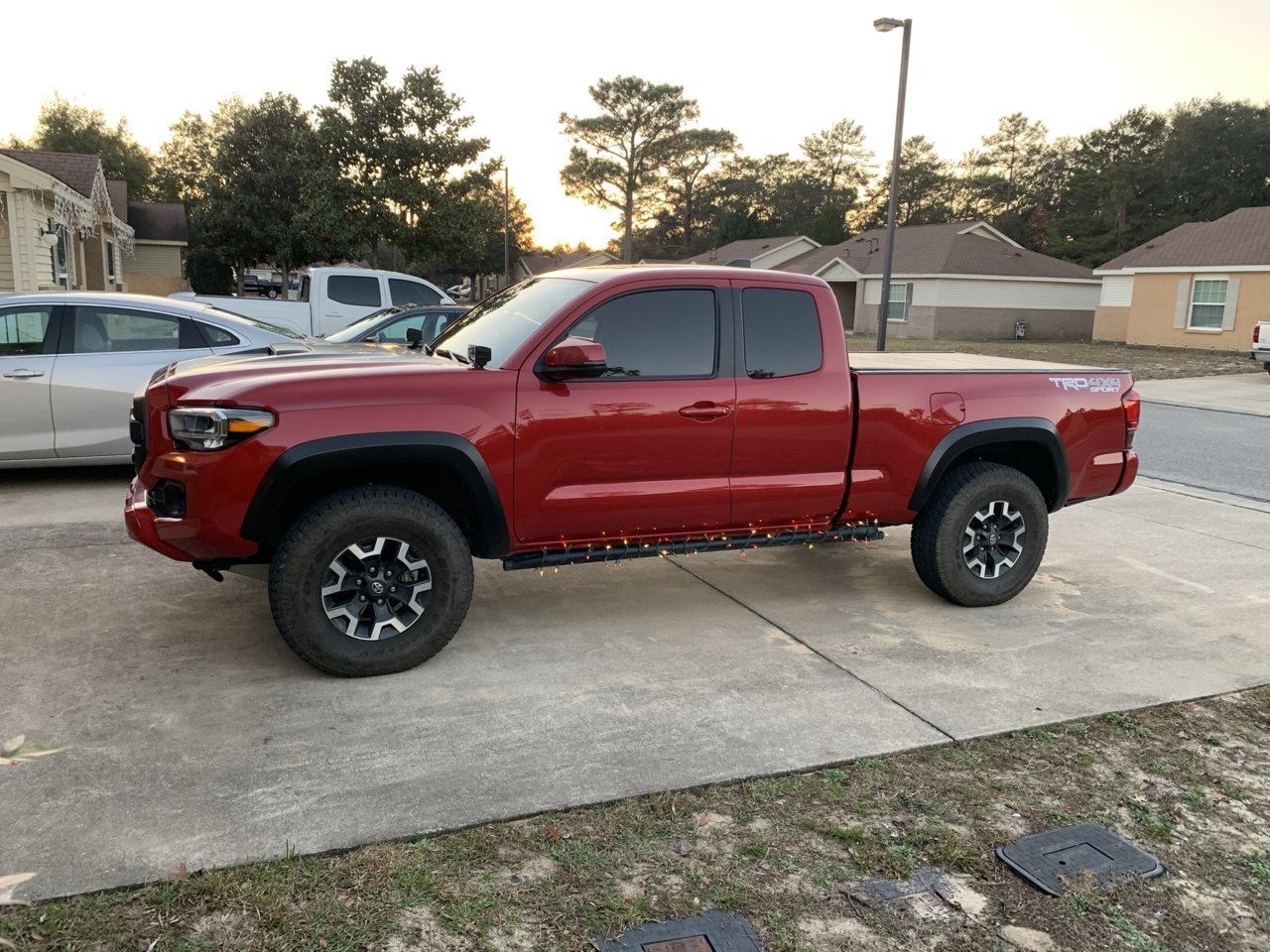

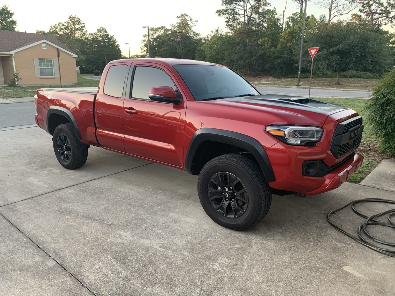

    Update on 6/11/2020:
    So after almost 2months with the lava_taco I added a lot of stuff most of it minor but something none the less and I've got acouple more things waiting to get here once it's off back order
    This is how she currently sits
    Mod list so far
    Partial hood, fender flares, b pillar and machined part of the wheels wrap
    Diode dynamics ss3 pro sae amber fog light
    Xpel Cermic tint 70% windshield 20% front 5% rear
    Pro grill swap
    Chin spoiler delete
    Ac drain mod
    RAV4 oem driver mirror with blind spot mirror
    Flat black tail gate letters
    Oem bed light with oem switch
    Rough county trifold tonneau cover
    AJT Design chrome delete steering wheel emblem
    Meso customs Vent rings and 4x4 ring
    Meso customs stage 1 total tail light kit
    3D Tacoma dash letters
    Anarchymotive weighted shift knob
    Led swapped all interior lights and outside lights
    Oem Tacoma bedmat

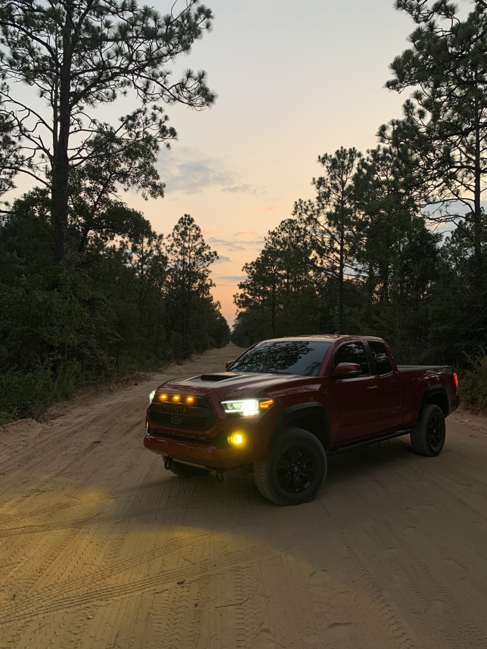

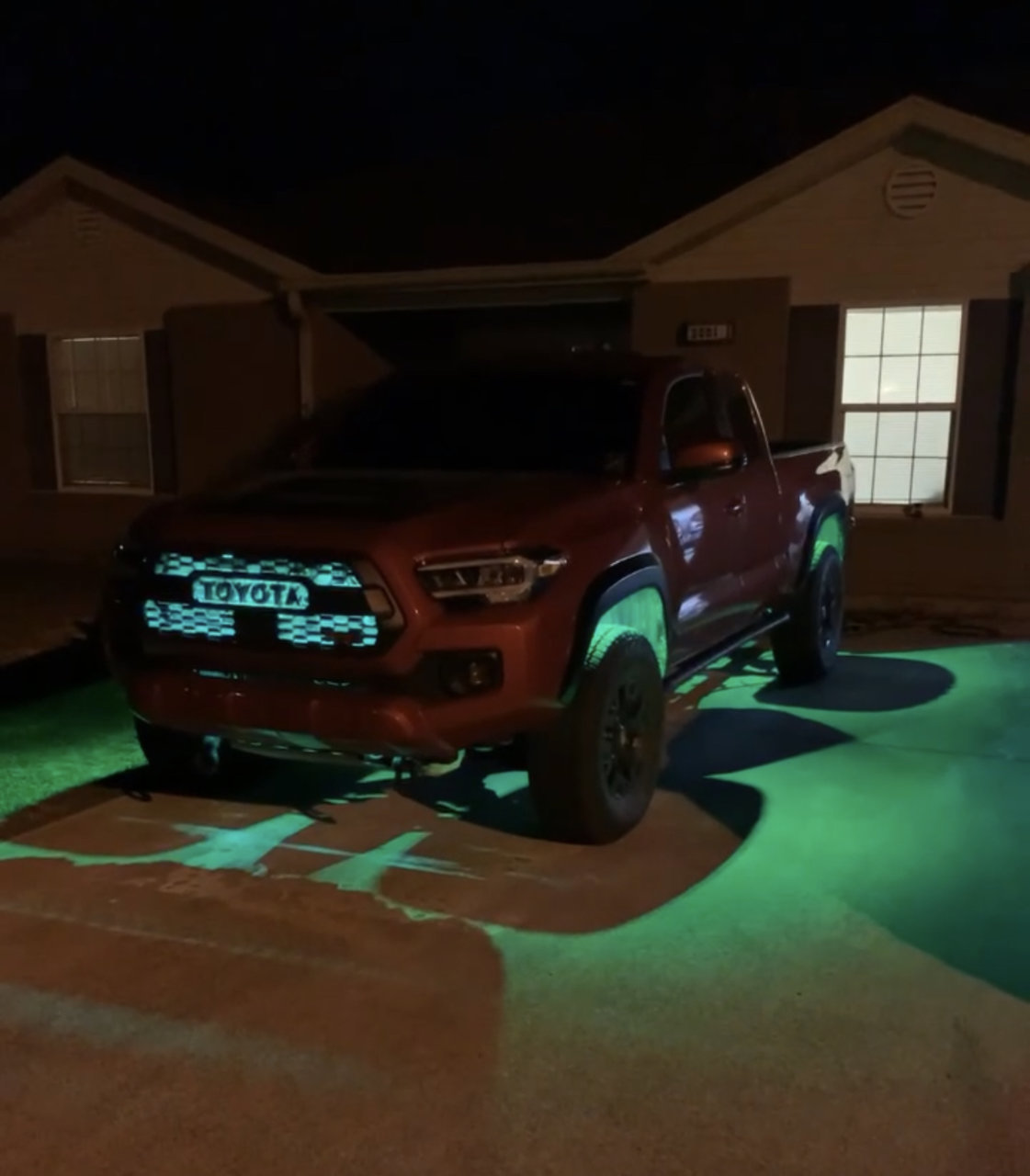

    The RGBW rock light
    I’m thinking of replacing them with the new KC Cyclone Amber lights tho because they are much brighter then these and simpler wiring setup too

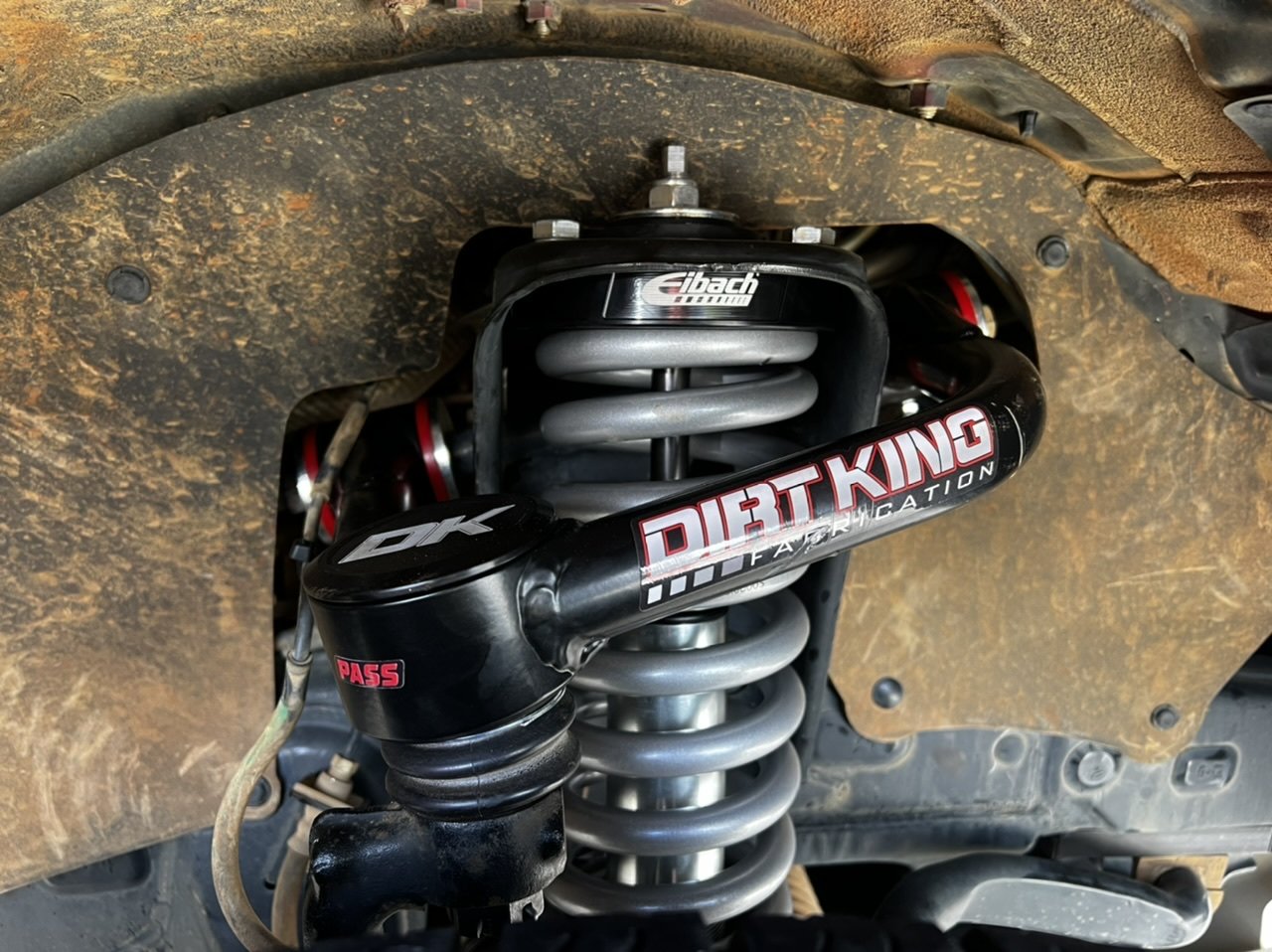

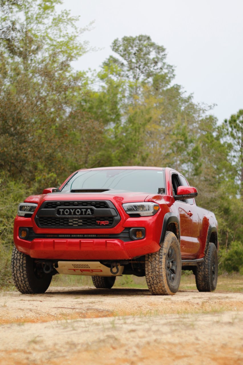

    Finally go my lift on it a Eibach 2.0 coil over with dirt king ball joint UCAs
    I also did the needle bearing replacement with the ECGS Bushing. That was definitely a nerve rack experience.
    Did a wheelers add a leaf in the rear with some 2.0 fox resi w/adjs shocks
    I probably would not do their add a leaf again because it required us to disassemble the entire leaf pack to get it to fit in because the spring clamps were in the way and i will be replacing here in the near future with the Icon RXT leaf pack just need to order it
    Replaced the front diff fluid just to be safe with Amsoil
    my starting measurements were (Will update later with need measurements)
    Before lift-------------Final lift measurement----------Difference=Amount of lift
    Df 21.5" --------------24"-------------------------------2.5"
    Pf 21.75"--------------24.25"---------------------------2.5"
    Pr 22.75"--------------24.75"---------------------------2" - this number is probably low because I have a PVC water tank in the bed on that side that was holding about 8.5ish gallons of water
    Dr 22 5/8"-------------25"------------------------------2.375"
    After lift without adjustments
    DF 22.75"
    Pf 23.25"
    Dr 24.75"
    Pr 25"
    After 1 full turn driver side front
    DF 23"
    Pf 23.25"
    Dr 24.75"
    Pr 25"
    After 3 turn driver front
    DF 23.25" 1.5 thread showing
    Pf 23.25"1.25 thread showing
    Dr 24.75"
    Pr 24 7/8"
    After 6 turns driver front
    DF 23.5" 1.75 threads
    Pf 23.5" 1.25 threads
    Dr 24.75"
    Pr 25"
    9 turns driver front
    DF 23.75" 2 threads
    Pf 23.75" 1.25 threads
    Dr 24.75"
    Pr 25"
    Final height
    9 turns driver 6 turns pass
