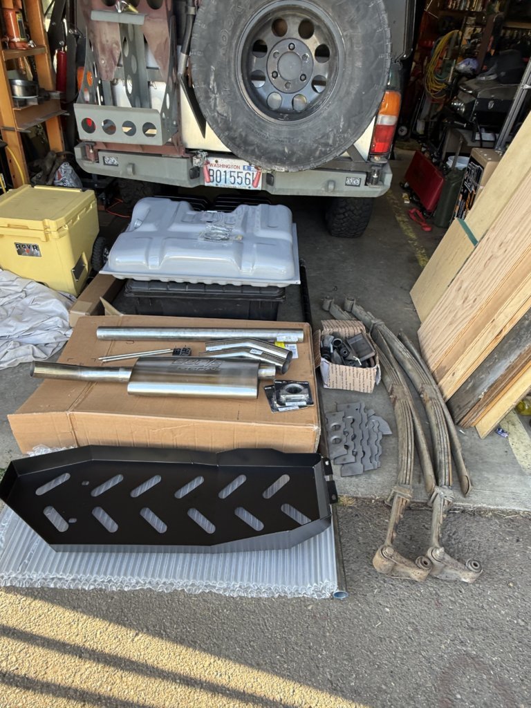

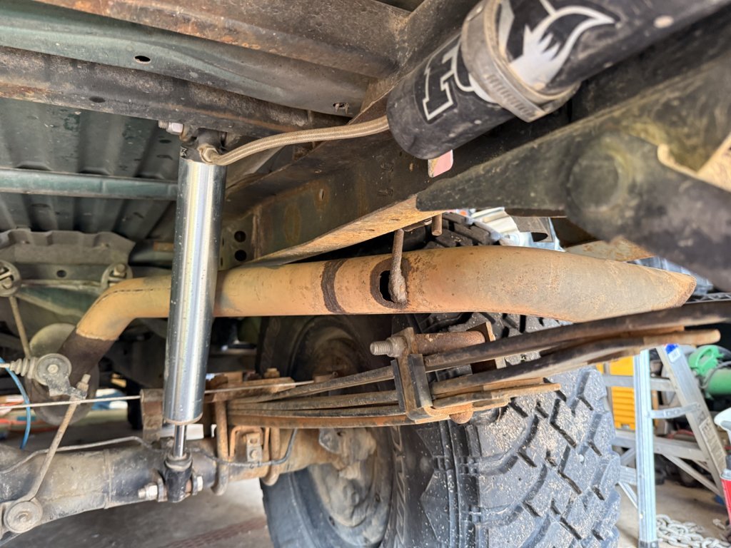

    Yes, the list is a bit over the top- been working on things in the evenings after work, I feel confident I’ll get the necessities done and start after some niceties, not sure about the rear though. Wouldn’t be the end of the world, but the T100 springs I’m on are pretty clapped out. They’ve made driving with a lot of weight scary at times.

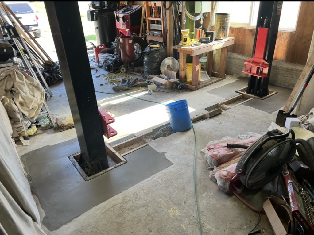

    IMG_4730.jpg I do have some advantages that will assist in doing so if I get to it ;) Using a two post lift will definitely help cycling the suspension and hot having to mess with jack stands.
    I do plan to French the hangers as well as swap the spring perches and get the pinion angle dialed in. Years ago I tried to recenter the axle by drilling new holes in the stock perches since the T-100 leafs pushed the axle about a 1/2” to the rear, so they’re done and ready for the trash.
