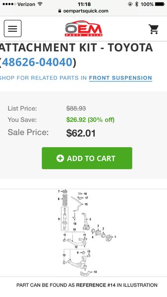

    Dealer can't get me the bolt until Tuesday. I'm 2.5 hours from home. I thought to call around to a couple auto parts stores and buy a new LBJ and just use the bolt. But all I can find is the actual ball joint. How would I find the part that connects the LCA/ball joint to the spindle? What's it called?
  17. Mar 4, 2017 at 11:19 AM
    #37
    GPsevinSixx
    GPsevinSixx Well-Known Member
    Aug 15, 2016
    #194631
    3,021
    Ros Angerus
    2015twoAX2.4techPAWS
    6112/5160AALfnCNTSTRyokG015
    Part number 14
    https://www.oempartsquick.com/oem-p...yMDE2JnQ9dHJkLW9mZi1yb2FkJmU9My01bC12Ni1nYXM=
