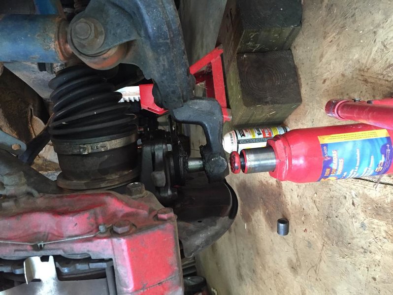

    Well the truck drives great now and was an easy job. Figured out a nice trick to get the studs out. Used a bottle jack and jacked up on the stud and lifted it an inch or two. Then hit the side of it with a hammer and it popped out with just a few hits. Hope it helps anyone that hasn't done it yet.
