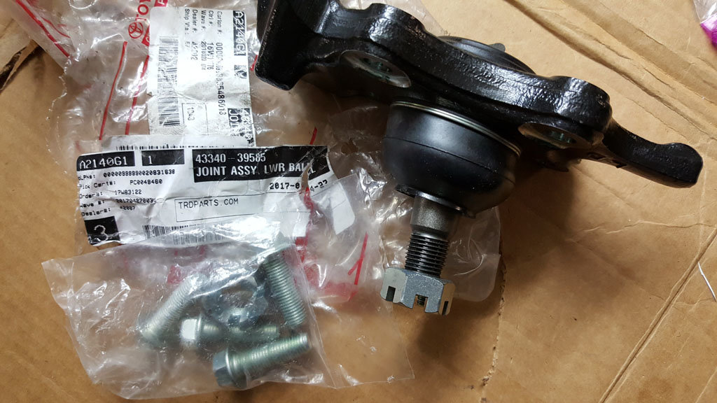

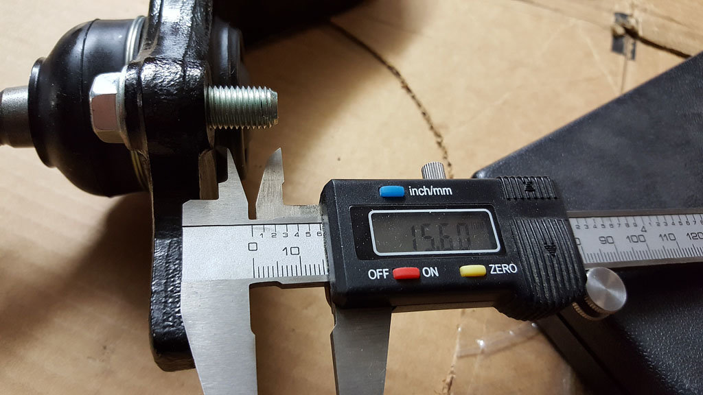

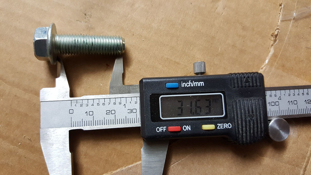

    This is what I got for EOM part number (for left LBJ my 95 Tacoma 4x4 ext cab) 43340-39585. It comes a a set the ball joint assembly and a bag of 4 bolts, one cotter pin and one castle nut:
    All four bolts are flange type length 31.5 ((or so) - all threaded
    The "thread engaged" part is about 15.5 mm long - that is more than enough for full shear strength.

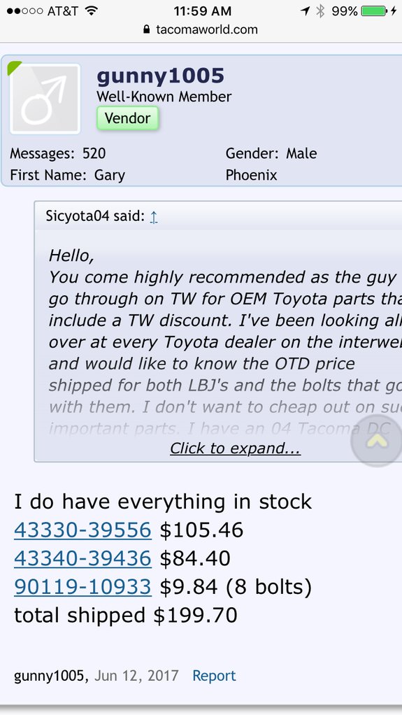

    Heres the prices he quoted for mine with bolts.
    43330-39556 $105.42
    43340-39436 $84.44
    90119-10933 $10.00 (8 bolts)
    He's in phoenix so shipping shouldnt take long to cali. (However, he doesnt package them all that great. Just threw it all in loose in an oversized boxo_O.)
    Question for you guys though.. Thoughts on using red loctite? Pretty sure thats what got used on mine this last time. Should i be worried when it comes time to replace them again in the future?
