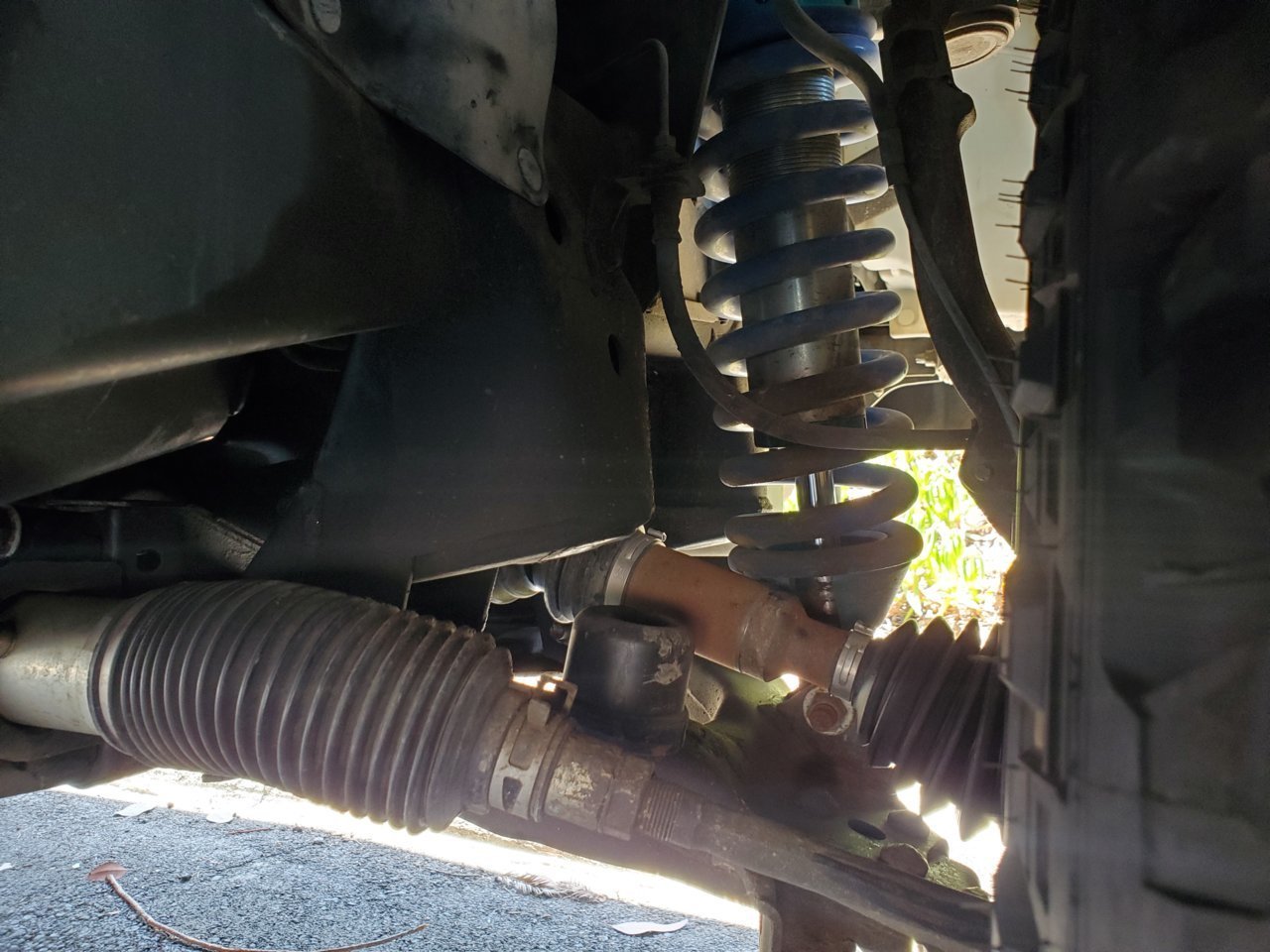

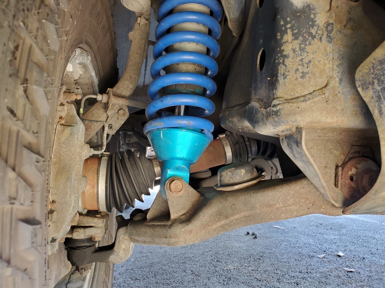

    This is stellar question asking format! TW should template this and stick it.
    The CV's look OEM. If you have the time and desire to reboot them yourself, definitely do it. If not, get some parts store CV's and reboot the OEM ones at your leisure. Fun and sometimes frustrating depending on the snap ring pliers.
    No need for new LCA's unless there's serious rust issues and/or need new bushings and don't want to replace bushings DIY style. Most of the time if the cam bolts are seized, the bushing are shit as well. Definitely buy new OEM LBJ's.
    New, adjustable UCA's never hurts but may not be necessary as stated previously.
    The cost for a mechanic and parts is going to be stupid expensive for the simple things you need. You would be money ahead if you could buy the tools and parts to DIY. Guess that depends on if you have another vehicle to drive while you wrench and some modest space to make the repairs.

    thanks for the reply and wisdom. A couple things: 1. I do have another car so this truck is just my vehicle to romp occasionally in the woods. I probably put 5k miles a year on it-maybe. 2. My mechanic is my next door neighbor. I trust him and he doesn’t charge me a lot for his work compared to what it would cost elsewhere. 3. I went ahead with ordering JBA UCA since they come with UBJ already attached. 4. I got Sankei 555 LBJ since they saved me $200 and seem to be pretty close to OEM. If I get 100k out of them it will take 20 years. That’s okay w me. 5. I’m still stuck on if I need EXTENDED cv axles for lifted vehicles because of the lift or not. If so, then I’ll need to do both. Price difference is negligible so that is not a factor. Thanks for the help!

    I have 3" of lift with OEM cv axles no problems. Many others on here are in the same boat with anywhere from 1-3" of lift without any extended CV axles. Your case should be no different

    You don't need aftermarket UCA's or extended cv axles.
    Your angles are less severe than mine were with my less than 2" of lift. I bet you're well under 2" lifted over stock height.
