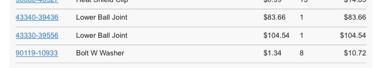

    Hmm you're right. Part numbers are a little different for the pre-2001 models. I think those come with bolts already though. They are the ones that don't have washers on the bolts.
    2001-2004, you have to get the bolts separately, they have washers because of the rubber dust boot (that's one hypothesis anyways)

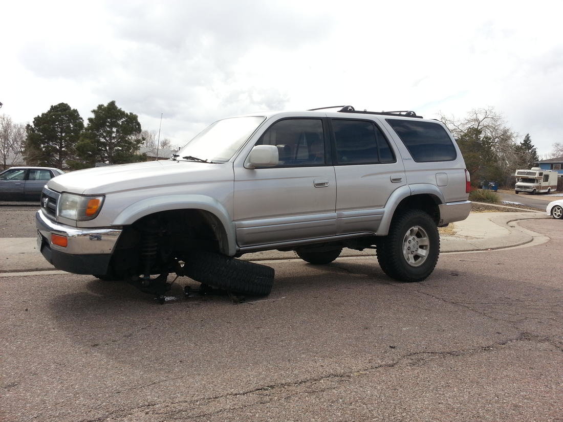

    But when a vehicle has loose ball joints it can be hard to align and they will notice this. At the time of the alignment they brought me in and had the vehicle on the rack. They used
    You would think so right. I checked them. They checked them. Then this happened.

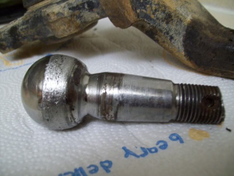

    Do you have close-up pictures of the ball joint itself?

    I watched many pictures of failed ball joints. Other than this one was complete dud I have no explanation why new-looking ball got pulled from new-looking socket without showing any sign of free movement just before that. Then it really did not matter if you had 200k miles or 2 miles on them. LBJ don't fail like that. While your case is quite interesting and result the same, it is not common and does not apply. The ball can't be pulled out from the socket unless it wears out at the neck and grind out the socket collar. This is how failed ball looks like:
    192144d1501885158-tundra-catastrophic-ba_03920af0c80db260dcbdae861cf88bbbf2a3b967.jpg
    But before the ball can be pulled out of the socket there will bet visible play when the ball is pushed inside the socket - in our 1st gen Tacoma it is hen the truck was lifted by the frame or LCA and tire weight is pushing the socket down on a ball.
