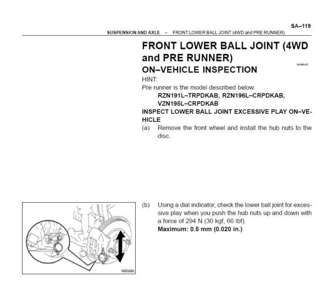

    Let's see if anyone can find the two significant problems with the factory procedure for checking a LBJ. These issues can significantly mask perceived wear.
    Then we can look at the relevance to "checking" an aftermarket 555 joint.

    Can anyone visually see 0.5 MM?? Nope! Basically, if you can see it moving at all, it's waaay out of spec

    That's about the thickness of a match book cover and unrelated to the two issues I have in mind.

    Assuming that you even own a dial indicator? Cuz I don't.
    Also, what holds the dial up?
    Also, when your whole assembly is in the air like that, your springs are pushing the control arm down. Not sure if 66lbs of force would overcome the force of the spring and shock, at least with a lift. When I put my 5100's in, I had to have someone press down the on the control arm to get the assembly in.

    This is why you need this: or what is shown on the manual plus

    All unrelated to the two points.
    But while I'm here. Look at the drawing again and note that the magnetic base of the indicator is shown stuck to the LCA with the indicator tip on the LBJ housing.
    The 66 lbs of force is not intended to move the shock, spring or lca regardless of lift.

    Na, in the real world you don't need any measuring device. He is mostly correct in that if you can see any movement it's time to start making plans. Not necessarily "way out of spec" but time to start shopping for replacements non the less.
