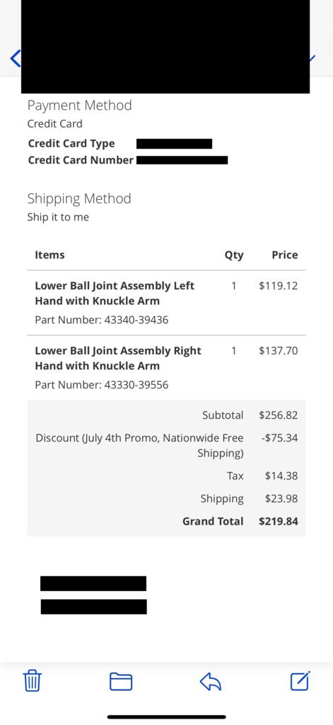

    Going for the LBJ replacement on my 1995.5 SR5,
    ordered 43340-39436 and 43330-39556 but received a message from the dealer that the correct part numbers are actually 43340-39585 and 43330-39815
    all my research states the original ones I ordered are correct, but just wanted a second opinion here
    thanks y'all

    Welcome to TW . . . . Ourisman (formerly McGeorge) is pretty good, they caught me once mis-ordering link bushings and they were correct. When you enter the VIN on their site what does it give you?
    As in t0p_dog's post those are the correct numbers for mine, but you may have a 5 lug or otherwise different, what do you get when you enter the VIN on their site? I'm guessing they are correct.
    Whatever you do you definitely want to make sure your set comes with a new castle nut and 4 new bolts, do not re-use the old ones. There are two sizes of bolts, the one with the rubber dust guards is a little longer, confirm it with them.

    Their site actually turns up a completely different set than what their rep reached out to me and suggested. I already ordered new bolts, 90119-10933.
    These are the longer ones for the joints with the dust boot. Do you know if these are compatible with non dust boot LBJ?
    Relatively new to the game here, I have based most of my info off adventuretaco
