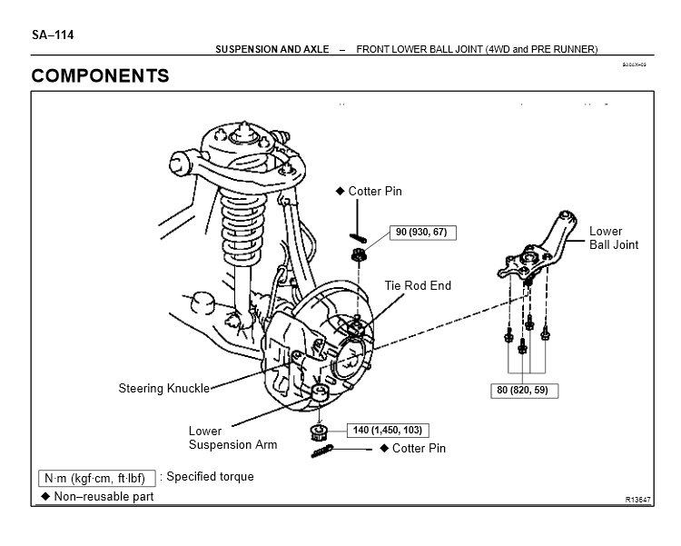

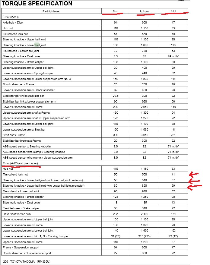

    Note that torque specs with LBJ protector are different than without protector. Hope this helps.

    Make sure you read the ft lbs column when adjusting your torque wrench! Snapped the head off the first bolt I tightened to 80 ft lbs today!!! Then about 45 mins later I realized what I'd done.
