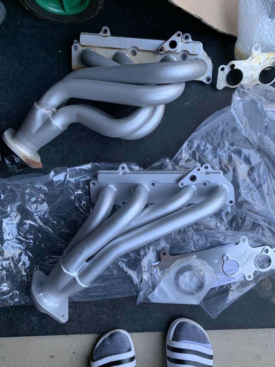

    Old style vs new style. Hoping to god the new one doesn’t leak.

    Looks like the new header design is not equal length, but hopefully it'll work out for you.

    ya not sure why they went away from it but at this point I didn’t even care about performance as much as I just didn’t want a header with a leak in it. And so far I’ve had better luck with this header.

    Both my lce header sets I recently received are the top header in your picture. Hope I don’t have to add that to my problem.
