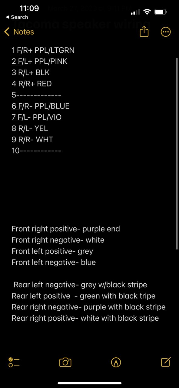

    As far as wiring, I tapped into the head unit wires for the lc7i input, I had the rears go into input 1 and the front in input 2 as I read in the forums. the remote out cable I sent to the speaker amplifier as well as a power cable to the amplifier, the lc7 was grounded as well as the amp. The output is RCA cables where 1 and 2 connect to the speaker amp and #3 goes to the input of the Pioneer amplifier.

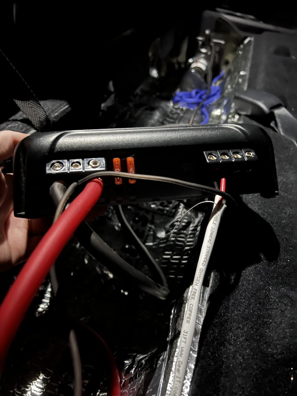

    The Pioneer amplifier is powered with a 4 gauge wire and grounded to the rear bolt for the middle seatbelts. For a remote wire I used an add a fuse with the cigarette fuse and made sure I had a 15 amp fuse on it as well as thats whats stock.

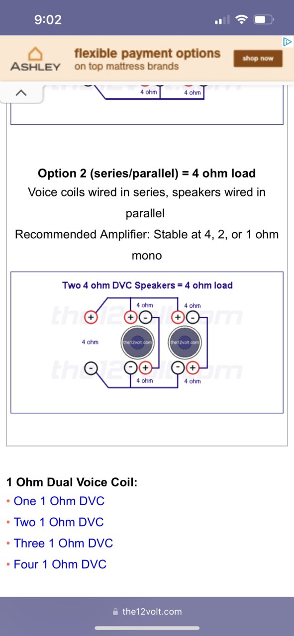

    For the sub wiring they are wired to the first two positive and negative in a parallel pattern I believe(its my first time i was hoping i did it right !).

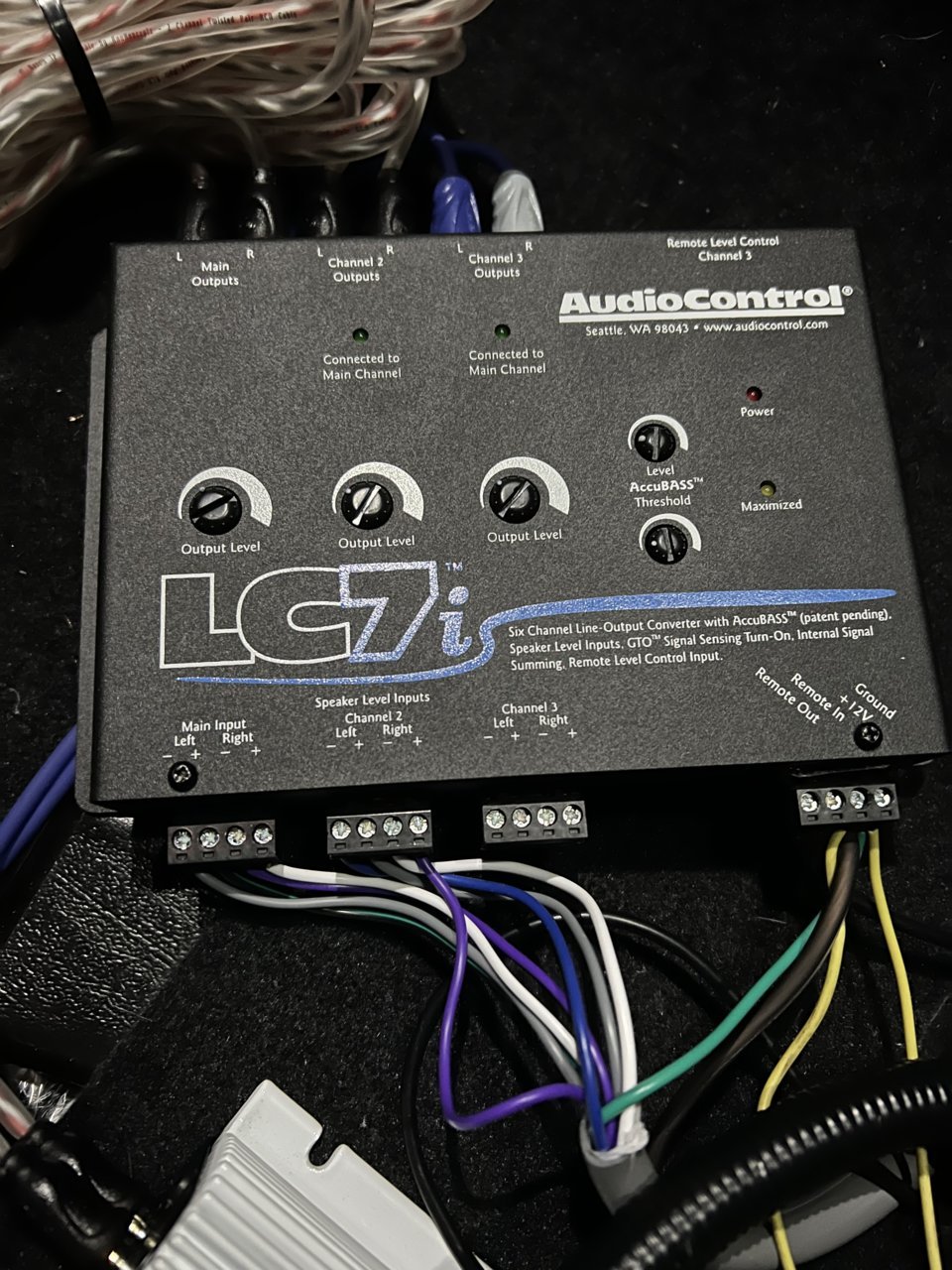

    Hello! So far I’ve noticed that I have a brown wire that’s running to my sub amp remote but I have it connected to the lc7i 12v instead of the remote out, I included the wiring diagram I used as well as I used Tacoma world for it

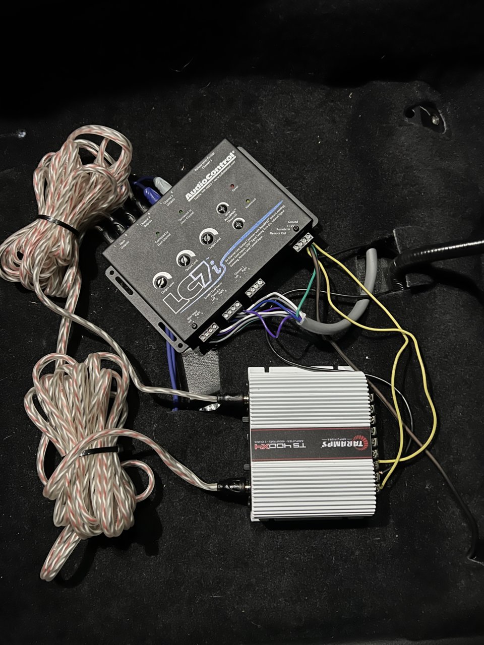

    thanks for the pics, it helps a ton!
    the first issue you note is "i disconnected the rca's, and music still played"

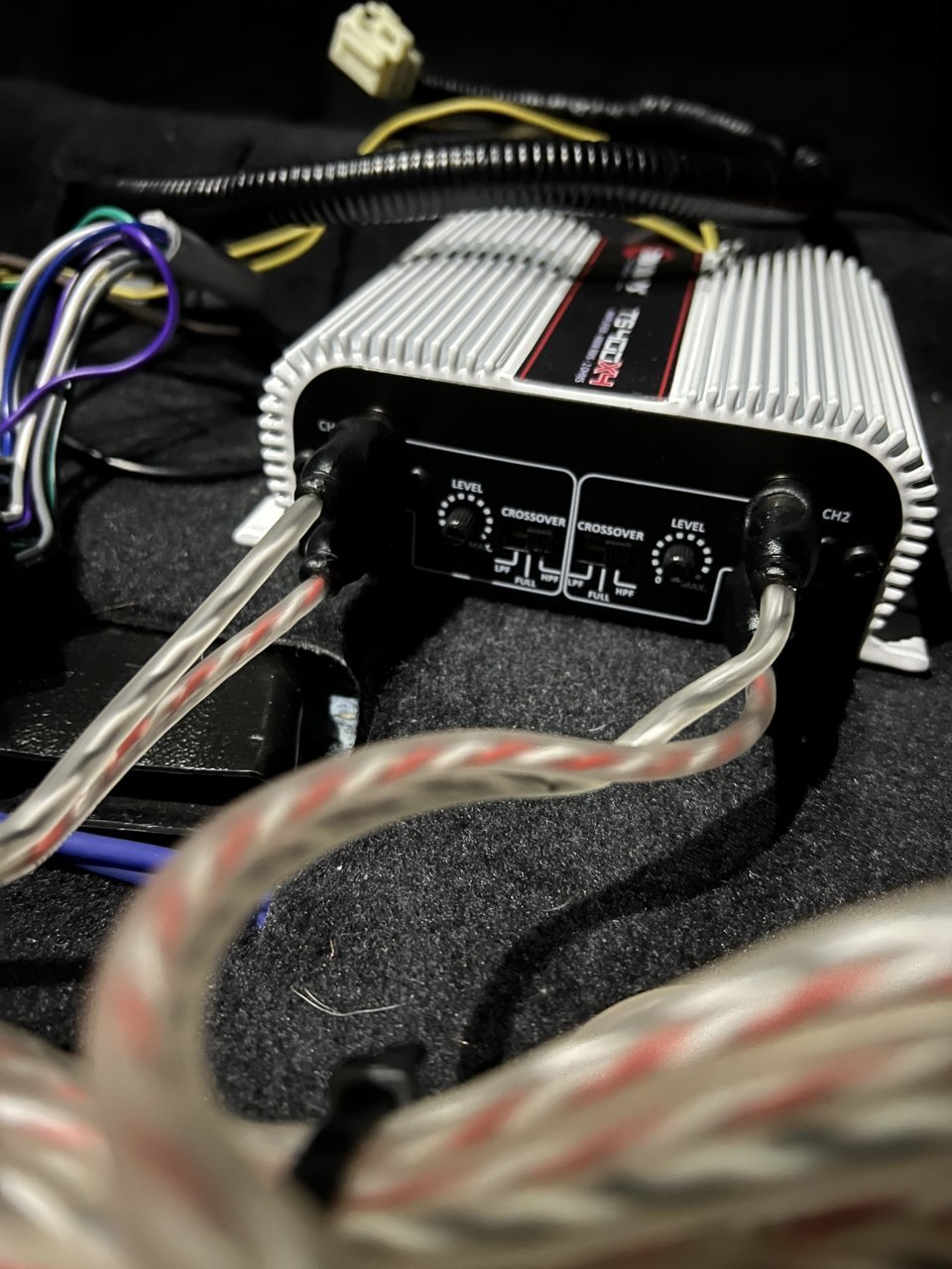

    looking at the amps, it appears that you haven't ran any speaker wire from the taramps 4-channel amp to the speakers. meaning that the speakers are still powered off the head unit, and are operating as intended. you'll need to run additional speaker wiring to the amp to correct this issue, but also to make the door speakers powered by the amp.
    2nd, you don't mention jumper settings, but don't have an input going into the 3rd lci7 channel. did you configure the lci7 to run off the main channel? i would also recommend making the main channel the front doors, as the oem head unit does have an eq that cuts some bass out of the rear speakers, so the front channel is what needs to be feeding the sub, but with the lci7, that's only possible if the front channel feeds into 'input 1'.
    the 3rd issue i'm going to note is a bit of a house-keeping issue that i feel is contributing to many of your issues. i used to do exactly as pictured with my amps-- fit them wherever they fit, jam them in a corner, use what i got, " it only needs to work until ____, it's only temporary until ____". what i learned is that it makes every issue and every small problem even larger and harder to track down. one of my cars went through 3 iterations of that, over the course of the install it actually blew out 3 amps, a pre-amp, a head unit, and i spent close to $2k in 'premium' 'zero noise 3, 4, 5, and 7' monster rca cables at different times chasing down issues that were half related to throwing the amps into the trunk corner propped up by the sub box. i've got more money now in a 5 gallon bucket of now-useless rca cables than most people spend on amps!

    the first step is that i would recommend moving the gear to a spot that it's all mounted solidly so that it can't shift around, and is safe from hazards.

    This was the sub wiring diagram I followed

    i see that part in the manual. however, relying on the auto-sensing every time the system turns on could quickly be problematic in the future. i'd highly recommend changing the jumpers to the setup you need so as to force it to maintain the appropriate input regardless of external forces.

    As far as when I disconnect the rca’s the music no longer plays. I switched the front speakers to be the main channel the rears to be number 2 but I left the summing jumpers off as I wasn’t sure which would sum the main to the 3rd

    should be jumpers 1&3 on the 'sub' pins to the summed connection. easy way to test is to change the jumpers, then connect only the #2 speaker inputs. nothing should come out.
    alternatively, you could also just leave the jumpers alone and run a physical wire from speaker-in-main to speaker-in-sub to accomplish the same thing in a more mechanical method.

    I’ve tried the current things with no luck to get the subs to work, switched to sum on the sub jumper with auto mode on, tried it with auto mode off as well, I switched both jumpers for sub and rear to sum with auto mode on and off and still no sub output

    i started digging in the manual more, and can see i've been interpreting it backwards.
    best/easiest way to get something to the sub channel is to use a wire jumper from the front speaker input to the 3rd channel input.
