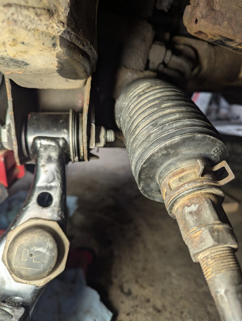

    I'm in the middle of installing new LCA's on my Tacoma and I picked up some of the SPC alignment cams and bolts from O'Reilly's. Have found conflicting info on how they are installed. Does anyone know if it matters which direction the bolts go into the control arms? SPC instructions say to put the rear bolts in with the head of the bolts facing the front of the truck, but with them installed like that they would be awfully close to the steering rack boots on each side. Thanks

    Concentrate on having the cam lob in most contact for adjustment
    If this means flipping bolt or adding washers so be it
    exactly how close to rack boots?

    Not touching but pretty close. I've worked on a lot of Toyotas, I'm not new to wrenching and doing all of my own work, I've just never had to replace lower control arms until now. I had to cut the factory hardware off due to it being seized, I called the alignment shop in town that I use to make sure they haven't had any issues with these SPC camber/caster kits before I bought them.

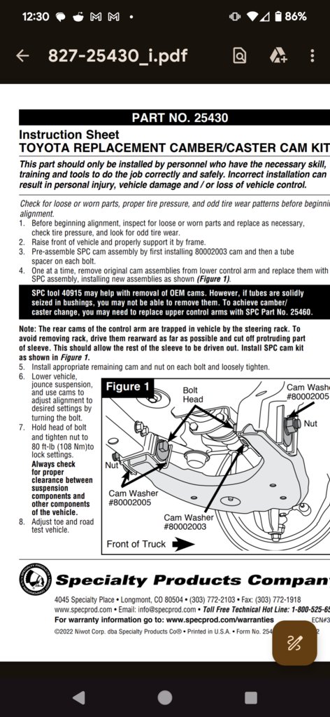

    from the factory, front bolts go in from the front and rear bolts go in from the back. They’re different than the SPC bolts however. If you can get the rear SPC bolts in from the front of the mount (basically where the diff and CVs are in a 4x4) it’ll keep you from having to unbolt your steering rack when putting the new hardware in.

  6. Mar 23, 2025 at 3:43 PM
    idahohounds92
    idahohounds92 [OP] Hounddogger
    Mar 15, 2025
    #467793
    23
    N. Idaho
    1999 Tacoma 4x4 extra cab 3.4l
    Those are the instructions I just found after making this thread. I switched the driver's side to match the instructions. I currently have the front end torn apart replacing the LCA's, upper & lower ball joints, inner & outer tie rods, steering rack bushings, CV axle shaft seals, shocks/springs and all new brakes. So it's easy to get to at the moment, but I wanted to make sure I install these bolts correctly while it's wide open and easy to get to. I don't want to install them wrong and the alignment shop can't align it and I have to tear it all apart again. I want to do it right, be done with the front suspension and move on to the 5 speed swap and a little bit of frame repair in the rear end.

    The rack is not bolted in but it will be just a hair closer to the end of the bolt after it is fully mounted..

    I had a SPC bolt on one side of my 2nd gen and it was fine with my TC cam tab gussets for mild offroading on BLM / fire roads. I did swap it for an OEM when changing LCA's further on down the road after a few years.
    Yeah that much clearance is normal for the steering rack boot. Basically the factory system is a bolt in sleeve style where you have to slide a long bolt and a long sleeve are going in from either side and that's why you have to unbolt the steering rack either way it's installed. SPC did it the way I said in the instructions you posted.
