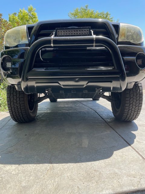

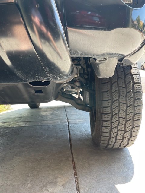

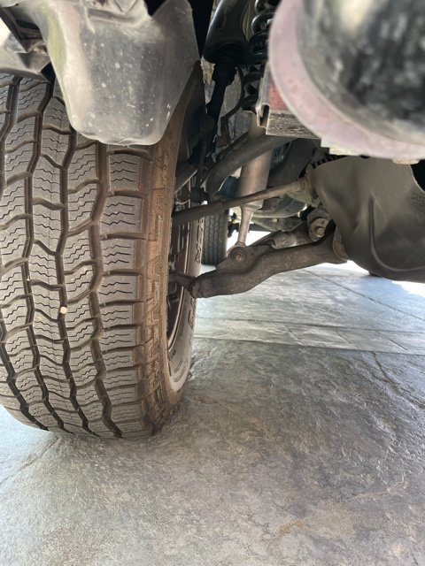

    Hello everyone! My 07 Pre-Runner has a three inch lift in the front and I noticed that my LCAs seem to be at a bit of a steep angle... I have tried googling to see if that's an issue or not (for longevity and component wear after the lift as well as driving comfort) but to no avail. I also notice that the other taco's running around my neck of the woods don't have this issue where their LCA's seem more parallel to the ground even though they're obviously lifted. I have thought maybe a "diff drop" or I guess cross member drop of sorts but I'm just not sure. (Yes I'm well aware the fact my truck is 2wd and doesn't have a front diff hence the " ") Attached is a couple different pics of the LCAs, along with the angle of the tie rod ends as well. Any help as to what to do (even if that's peace of mind) is much appreciated!IMG_2106.jpg IMG_2105.jpg IMG_2104.jpg

    It's a pre-runner so you don't have a front diff so don't worry about that. As far as the angle goes, the biggest problem with that (assuming it will align properly) on 4wd models is the steep angle of the axle shafts. You don't have to worry about that either.
    If it won't align, you'll have excessive tire wear but other than that, I can't think of any serious issues.

    Negatives are ball joint strain, tie rod angles both will get accelerated wear.
    Bump steer is another issue due to the angle of the tie rod ends.
