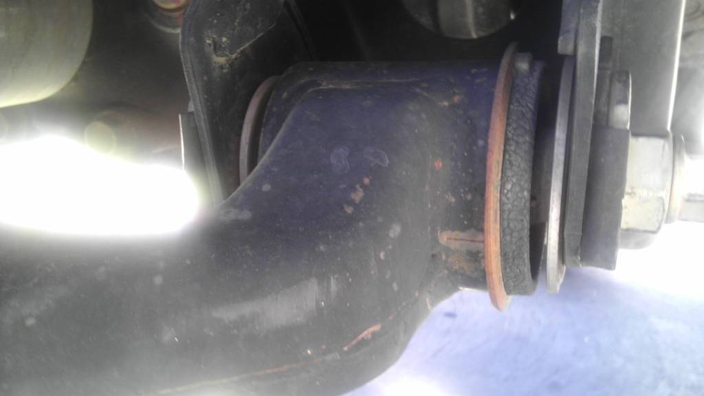

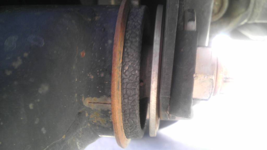

    I actually just bought new LCAs. Was asking about ball joint press just because I was interested in greasable ball joints. FYI a reciprocating saw is MUCH safer than an angle angle grinder (more precise)... Attached are photos for your viewing pleasure of some of my recent hardships... Also had to cut through rear leaf spring bolts (front ones)... getting the old bushings out of the a-arms was wayyy too difficult and and I forget what other issues there were. I just ended up buying new LCAs. My 5100s on one side were seized as well. I just cut the shock off to make things easier to work with. I was 18 (4 years ago) when I installed these shocks and replicated what Toyota had already in place (so I probably didn't grease them since I didn't know any better lol)
    ImageUploadedByTapatalk1349450270.800297.jpgImageUploadedByTapatalk1349450298.887422.jpgImageUploadedByTapatalk1349450324.340090.jpgImageUploadedByTapatalk1349450357.366421.jpg
    Maybe I'll get a build thread going when this is all done...

    That all looks way too familiar... giving me flashbacks to burning out the hole bushings! I got mine out the same way, good ole Sawzall :D

    One other pic...

    I couldn't get the rotary tools to work for me either. I toasted a bunch of Milwaulkee blades on one LCA bolt, then switched to a Lenox blade and finished the job with one blade. I dosed the crap out of everything with PB Blaster every day for a week before the project and used PB Blaster as cutting oil which helped a lot.

    Have you actually tried to take them out Ray ? I thought for sure my bolts weren't seized as I could move them but they were in fact seized to the inner bushing sleeve

    lol... I used up a bunch of Lennox blades and then changed to a cut off wheel and it cut like butter. Everyone has their own way best for them.
    not I. no issues whatso ever. your cut off wheels look thick. try thinner next time maybe :notsure:
    this.... loosen cam bolts, remove shock, and try to cycle the LCA. thats when you truly know whats going on down there.

    that has absolutely nothing to do with it. you can't see the problem. I could also show you pics of my seized ones and they look identical to my brand new ones.
    judging from the amount of rust your fubar :D
