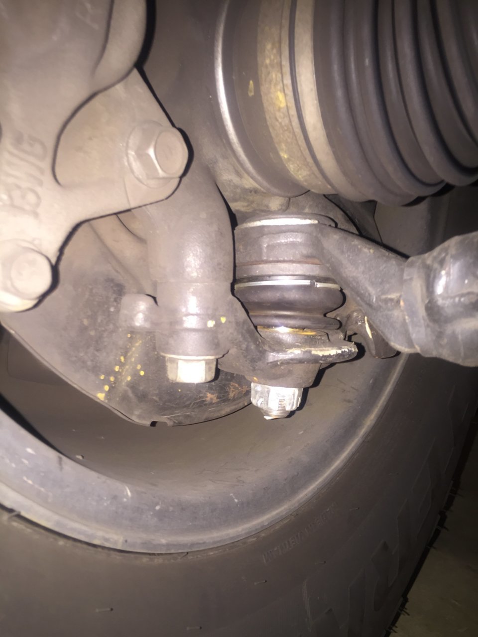

    Yes , I installed one of these 10,000 miles ago. So far so good.

    not sure if your installing yourself but it can be a bitch to do. may be easier to get the whole LCA with new bushings and ball joint all ready to go. can get moog LCA with it all for 100

    report back after the fact though. i did it once and it was a nightmare other side i did full replacement, took 20 min

    Yep, time is money, fight those bastards for 3 hrs or so , or a few bolts 20 minutes a side and be done with it.

    With the right tools, those lower ball joints only take 10 more minutes than replacing the LCA.

    In Texas, probably. In the rust belt, good F’n luck. Couldn’t get mine free while still on the truck. Probably gonna have to do new LCA, just wasn’t sure on how good the Moogs are.

    Are your LCA cams seized? Moog complete LCAs are good, they have a different BJ in them from what they sell as singles. For bout $100 or so more you can get genuine Toyota LCAs.

    Seized up bad. Heat, hammer and the ball joint press. Deformed one of the receiver tubes or whatever they’re called.

    Get the PN for each and google the PN. Online retailers sell cheaper.

    Cut dem bitches out.

    My UCA came out easy. Needed lots of lube for that tight rusty nut.
    Lowers were ok and bolts loosened fine.
    225k miles in salty mass area
