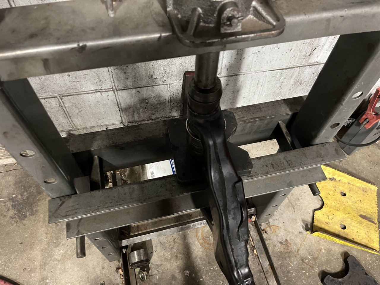

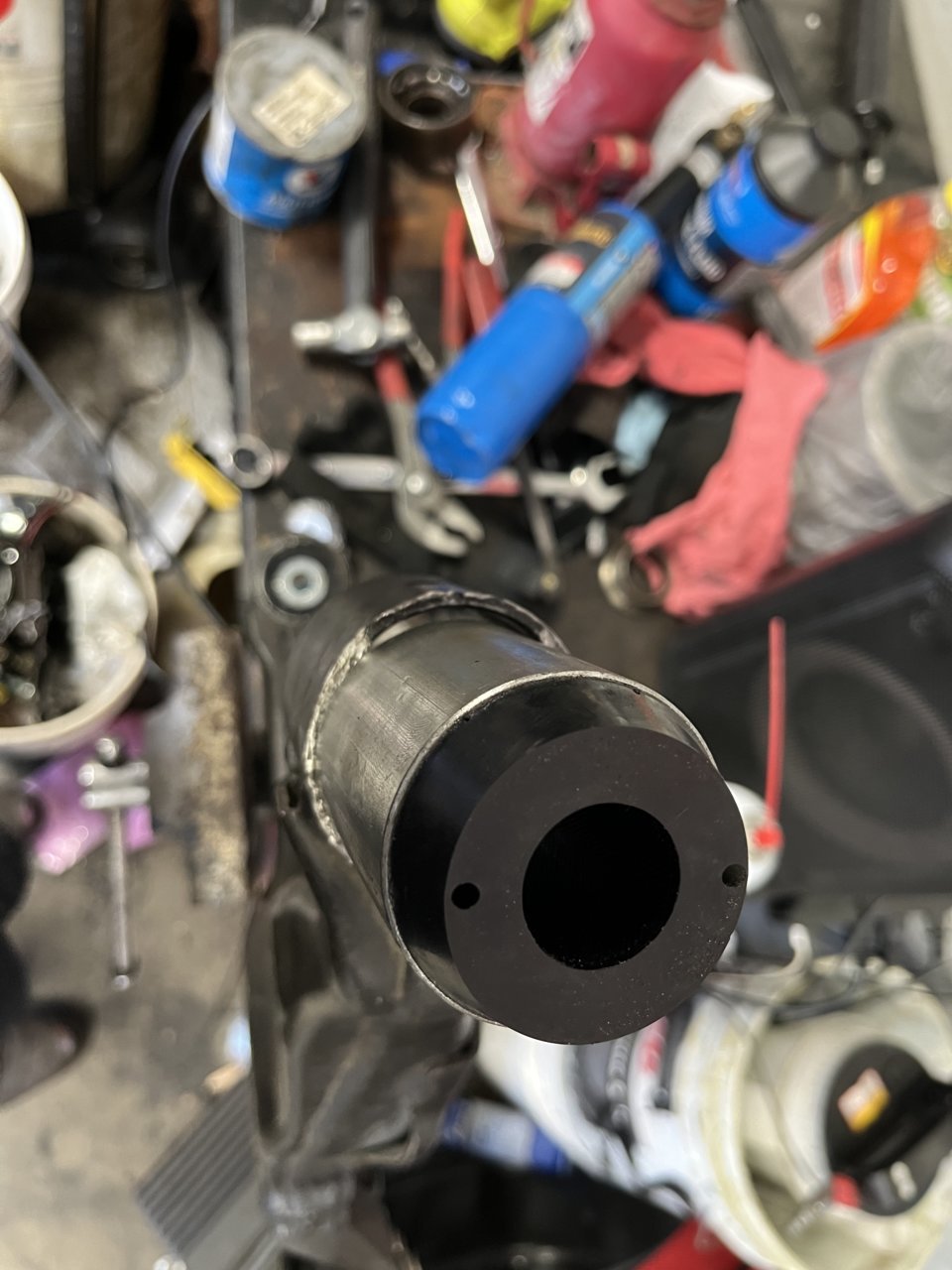

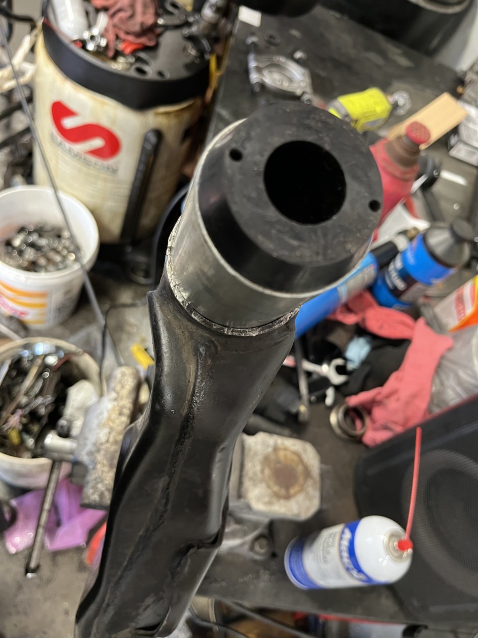

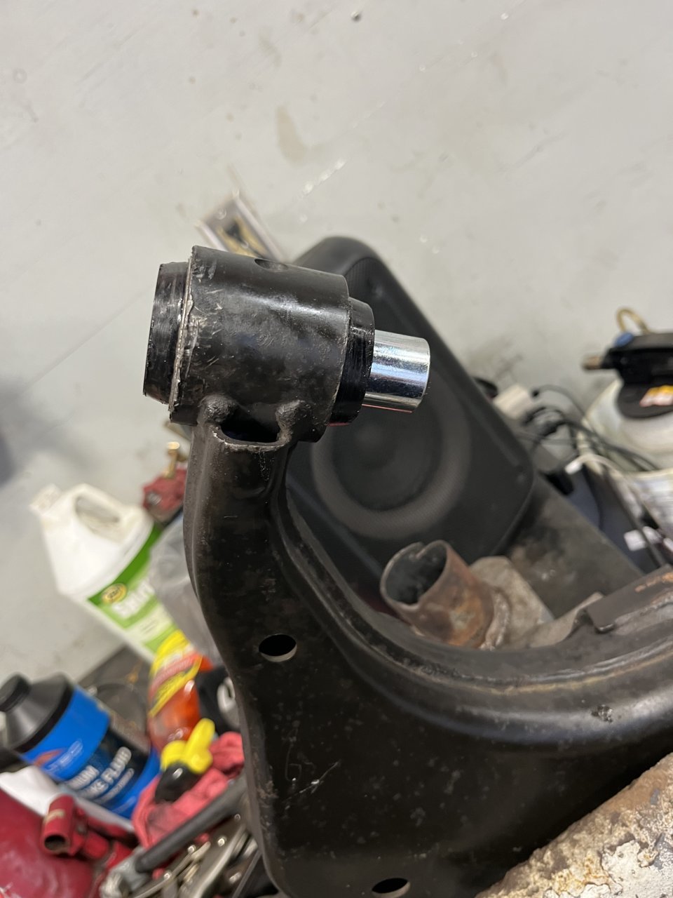

    So I tried going about this the way that Adventure Taco did it and I managed to break the bottom metal plate on the bushing, and now I can’t get the bushing pushed through the eye. What should I do from here? I’ve tried pushing just the middle part through the eye of the LCA but no dice. We don’t have cups for the press either, we have bearing bodies that we put a plate on top of and turn into a cup and there is one that is the perfect size for this. At this point I’m out of ideas on what to do. Any help would be greatly appreciated as I’m stuck at work until I get this fixed.

    Burn it out?

    That’s what I was thinking but then how do I remove the outer sleeve of the bushing?

    Without something to press with I think I would use a Sawzall and go nice and slow and make two relief cuts, maybe more, through just the sleeve.

    air hammer...

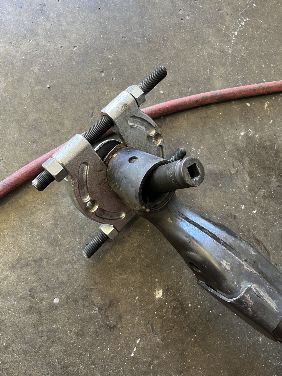

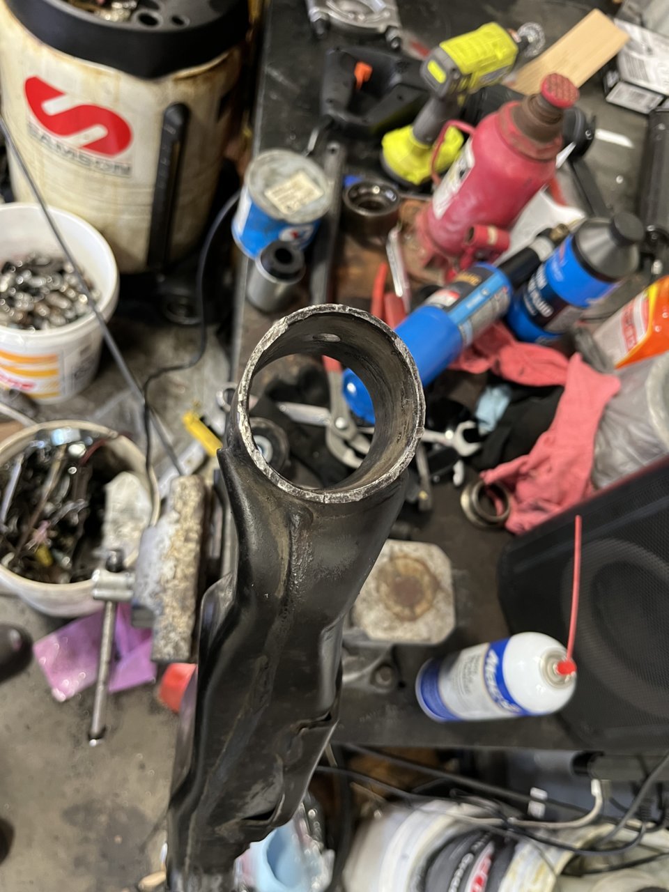

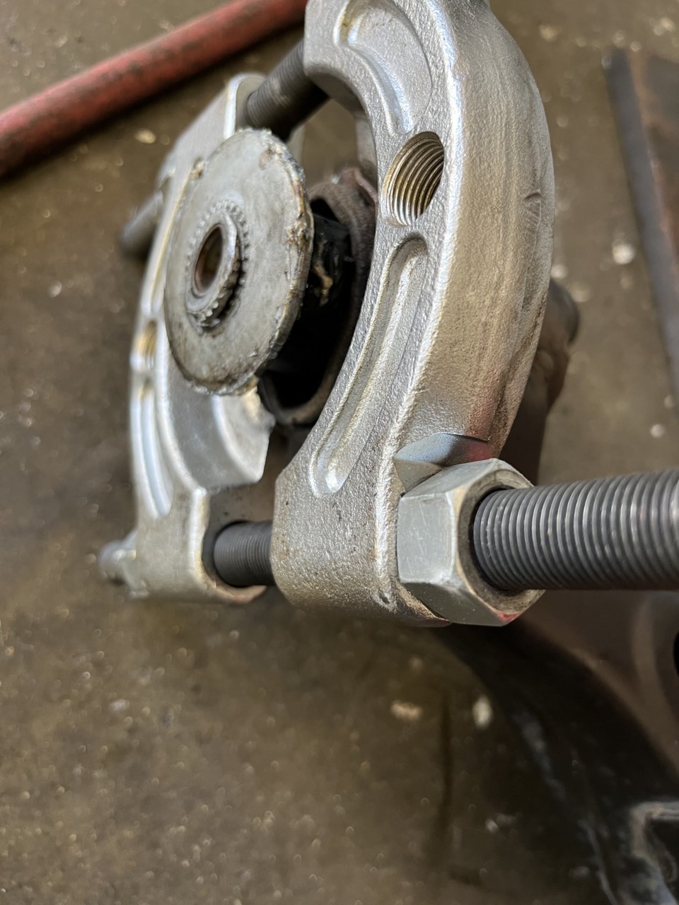

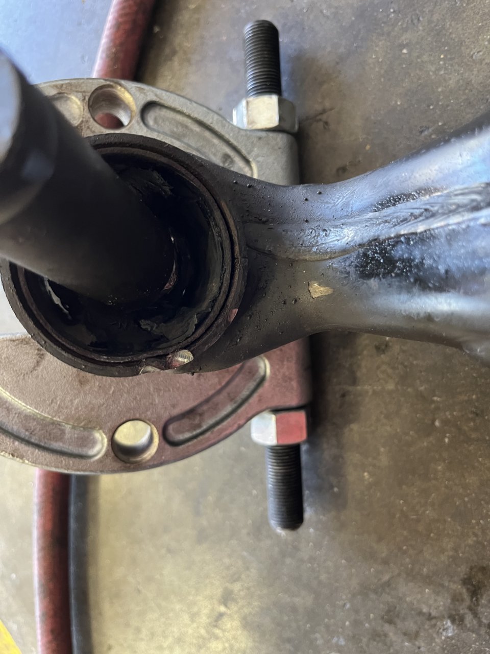

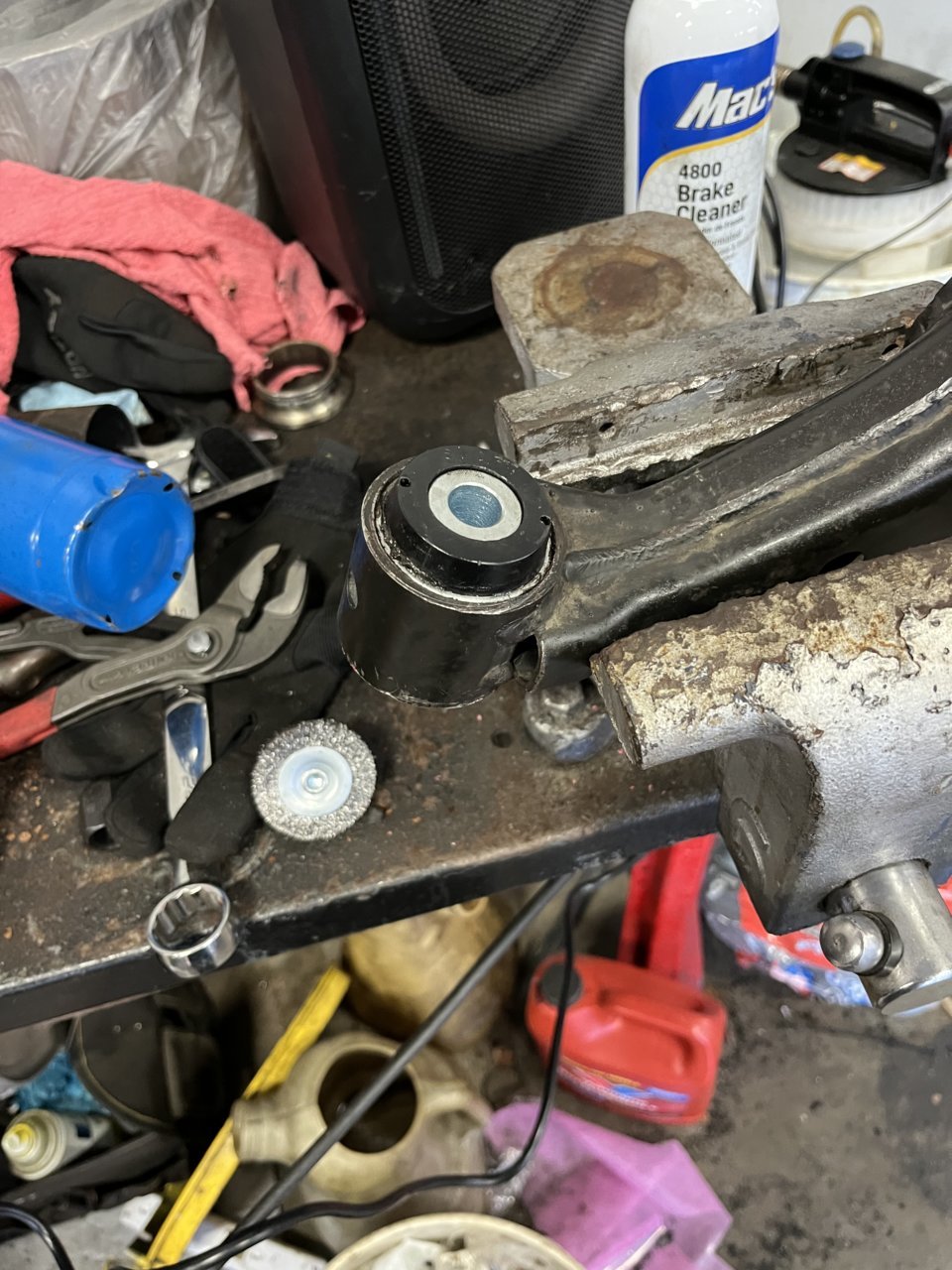

    EDE33221-9EE5-4650-9660-98ADC8FA0D9E.jpg 084F14CC-8EC4-441E-A71F-1A103F76D848.jpg C88FBF76-CC5F-4176-AF87-AF4C934FC2C9.jpg 2EDF13F0-DD1F-4D31-98B6-3AC9A6FE9F3B.jpg Update, got the sleeve cut out and smaller bushing pressed in. Now the larger bushing won’t push in because it looks like the eye somehow became an oval and not a circle. This is a nightmare. Any more ideas?

    Beat it back to round. If you can support it from the inside with the old sleeve or anything or may help.
    Go slow, you don't want to over do it.
    Maybe use a C clamp and try to clamp / squeeze it back to round

    This is how I’m leaving her tonight. Got a hub cone from our balancing machine and used the press to get it back to round. Went ahead and put the bearing back in the freezer. With all the heat I’m putting on this eyelet I’m just hoping it doesn’t fail on me once I hit a pothole. I still have a ball joint on this control arm to do and the other side tomorrow :boom:

    I used a little heat and a rubber mallet to get the eye back to a circle. I also put grease between the bushing sleeve and the LCA, hoping that it won't be seized if i ever have to do it again.

    I had to use a screwdriver and hammer to get the sleeve out of the LCA. I scored the sleeve first with a hack saw. Mine were in there for 190k and fused together.
    had to dremel/file the inside to make it smooth to take in the new bushing.
