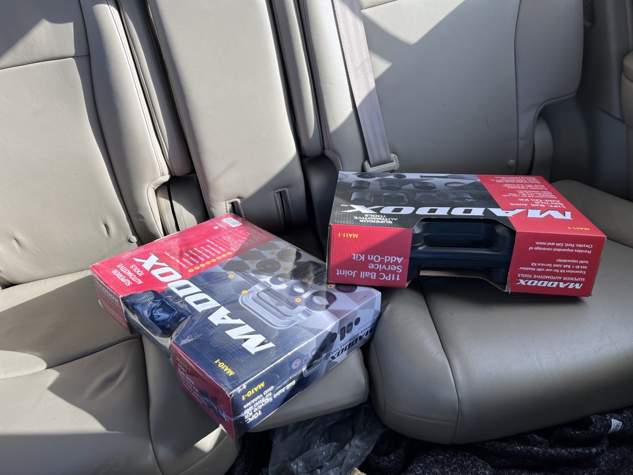

    After another midday harbor freight run I was able to get everything figured out. I took a piece of an older bearing that was just slightly too large and ground it down to the right thickness with the angle grinder. I was able to use it to start to push the bearing out then was able to push directly on the rubber to move it out the rest of the way. The bushing was a little damaged, some small rips that didn’t go all the way through the bushing but it’s good enough so I put it back in the correct way. Then I got the little adapter plate separated from the control arm and put the new Moog ball joint in. Got everything buttoned up and then did my alignment.
    I guess I finally figured out why my master tech laughed at me when I told him what I was planning on doing. I’m probably gonna wait a week or two before doing the other side, I need some time to recover mentally from this :rofl:
