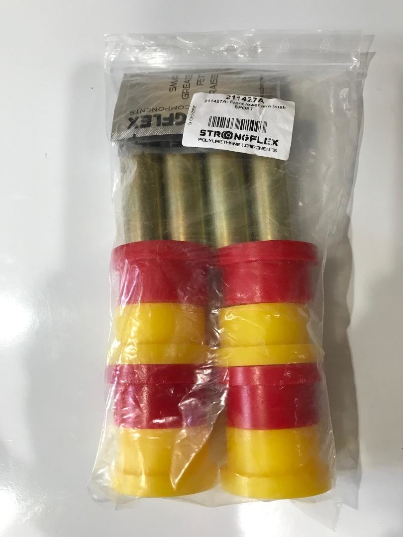

    I am currently doing heavy MTX on my '97 Taco 4x4. Just checked the LCA bushings and the RR LCA bushing is marginal. So while the Taco is on the jack stands, I am thinking it would be best to just change them out now. And I have a 20 ton shop press and all the other tools needed to do the work. The OEM LCA bolts get serviced as needed and are not frozen by rust. But I may replace or upgrade the attachment hardware. Whiteline & Strongflex are the best aftermarket bushings I know of. And both are excellent bushings. Have read the excellent "Step-by-Step" writeup: Step-by-Step Lower Control Arm Bushing Replacement on a 1st Gen Tacoma (or 3rd Gen 4Runner) – ADVENTURETACO. Kudos again bud! Whiteline bushings are much cheaper at $74 a set delivered. But I am leaning toward the Strongflex bushings mostly because of the ease of installation and MTX. If I have time, I may drill and tap the LCAs for 90 degree zerks/grease fittings so the bushings can be greased. The only decision to make with the Strongflex bushings is which grade to use: all (4) yellow or (2) yellow and (2) red. Any thoughts or pearls of wisdom from members who have replaced their LCA bushings would be appreciated. And TIA!
    EDIT: On disassembly, the RR LCA bushing was completely shot! Glad I caught it now.

    Just a heads up that I think the StrongFlex are currently out of stock, otherwise, I'm right there with you. (obviously, hahah! Glad you found the write-up helpful!)
    Definitely possible to use the bottle jack, but I've seen several sets of UCAs get bent out of shape this way. Always good to use a strap tightened around the outside to help prevent expansion. Success will depend a lot on how much rust/corrosion you have.

    I used the strongflex after reading Turbodb’s write up. I used the manufacturer recommended 2 yellow and 2 red, I have been happy with mine.

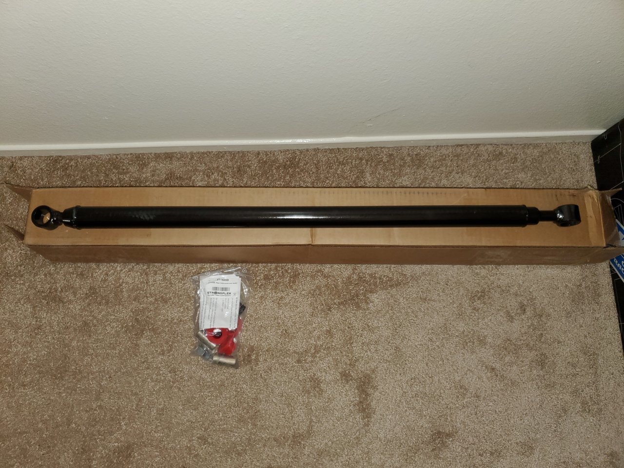

    Sonoran steel offers quality products, I don't doubt they'll have some good grease. I bought my adjustable panhard bar from them and in fact, they actually came with Strongflex bushings as well.
